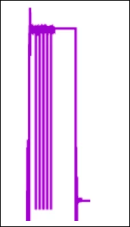

As we are verifying the Gyroscope data output of the LSM6DSO, we noticed the value goes to -3.311157 randomly.
Below table is an example of the issue.
We are rotating the device at a constant speed and expected the value to be around 35, but all of a sudden, while the device is still rotating, we get a value of -3.311157.
Is there an known issue with the LSM6DSO?

    Hi @KShah.2​ ,
    No, this is not a known issue. Are you facing this problem only on this LSM6DSO lot, or on just 1 part? You might check if I2C or SPI is stable during the communication.
