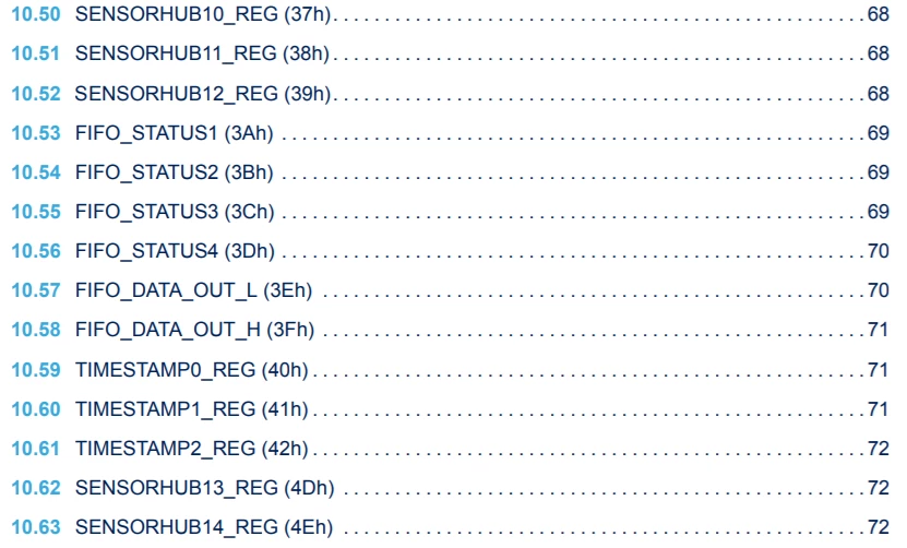

The issue might be related to the fact that the the SENSORHUB13_REG is not consecutive to the SENSORHUB12_REG for the ISM330DLC? There is a jump from reg address 0x39 to reg address 0c4D, and if you are using the automatic increment you should take this into account.
0693W00000KaH3YQAV.pngSENSORHUB13_REG to SENSORHUB18_REG are "normal" register as SENSORHUB12_REG and below.

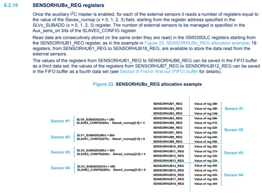

did you check if you configured everything as described in the Application note AN5125, p.62?
