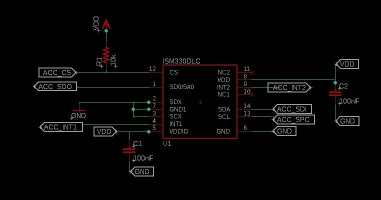

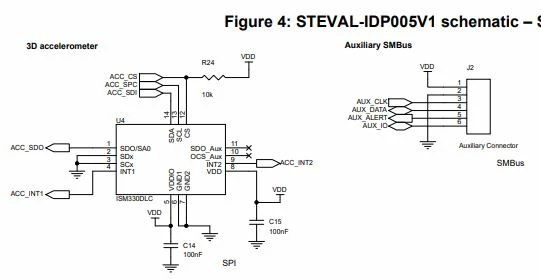

I have made a module using ISM330DLC IC. I made the schematic by taking reference from STEVAL-IDP005V1 schematic. PFA, both the schematics.
Now, I am using Nucleo -F44RE board to interface this module using SPI.
Also, using the libraries for the ISM330DLC.
When I am using the ism330dlc_device_id_get(&dev_ctx, &whoamI); API, the ID coming is 0x7F but in datasheet it is 0x6A.
But when I am using the STEVAL-BFA001v1b kit , I am getting the correct ID of the ISM330DLC which is there on the kit already.
Please, let me know the possible problem.

    Hi @RJain.1​ , are you sure you are correctly reading the WHO_AM_I (0Fh) register? It seems like "FFh" on 7-bit... Can you read another register to check if you get back the same value? And could you share the digital signal pattern? Just to check if you are receiving back the ack from the slave device. Regards

    if you are receiving all 0xff there should be some issue on the line. Are the GPIO pins ok? Is the SPI correctly configured at application processor level?
