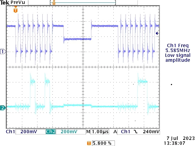

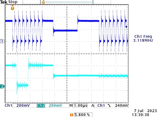

I have an custom board using the ISM330DLC but I'm having difficulty configuring it's primary bus for 3-wire SPI operation.
According to the ISM330DLC datasheet register CTRL3_C (0x12) must set to 0xC for 3-wire primary bus SPI mode to be enabled.
As can be seen from the following scope trace 0x0C is written to 0x12.
But when the 'Who Am I' register (0x0F) is read back 0x00 is received.
From the above I'm assuming that the CTRL3_C (0x12) command is not being received by the ISM330DLC as the SPI clock is not being pulled high as per the datasheet.
Before I replace the ISM330DLC can you please sanity check on the above?

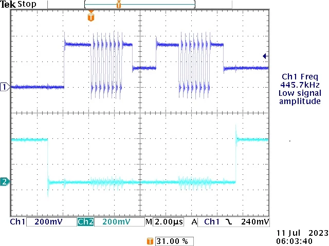

Hi @GnR ,
a few questions to try to better understand the problem:
first of all, can you confirm that the CS pin moves how it should?
just to be sure, do you perform some other operations between the write and the read functions?
have you the possibility of confirming with I2C if the sensor is working?
Niccolò

Hi Niccolo,
Many thanks for the response.

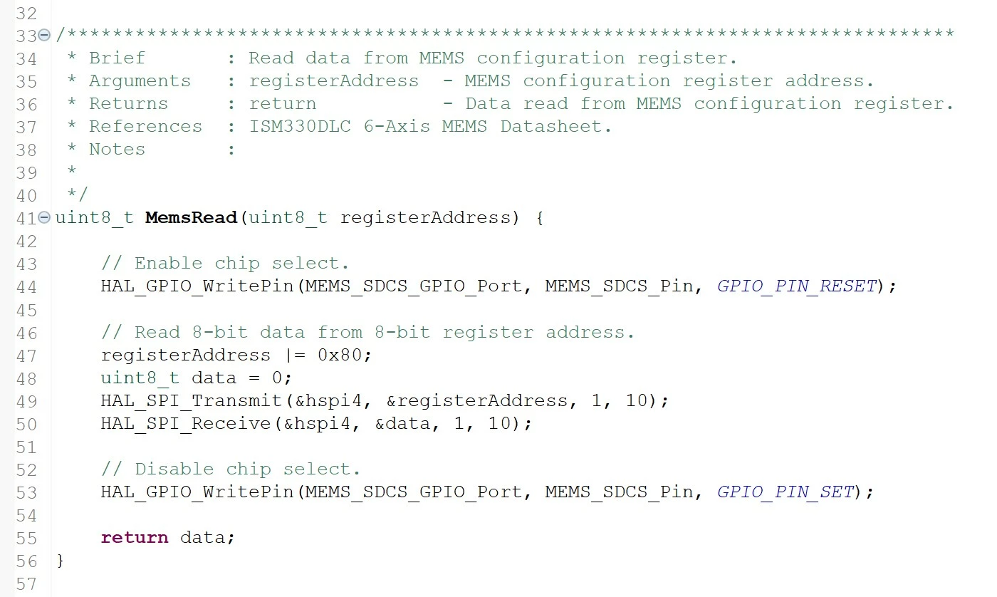

Find below the CS / Clock trace from the 'Who Am I' (0x0F) register read operation.
My SPI Register Read code is below which has no additional operations between the write and read function.

Hi @GnR ,
the CS is ok, the thing I imagine is that the sensor did not received the command to go in 3wire SPI, so it is sending the response on SDA, instead of SDO. (if you could check with the oscilloscope that pin we can try to confirm that the sensor is alive)
then, another issue that I can think of is the power to the sensor, so could you double check it? how much is Vdd?
I would check that before replacing the sensor, but just to answer your question, on the microcontroller side, I really don't see any issue with the communication =)

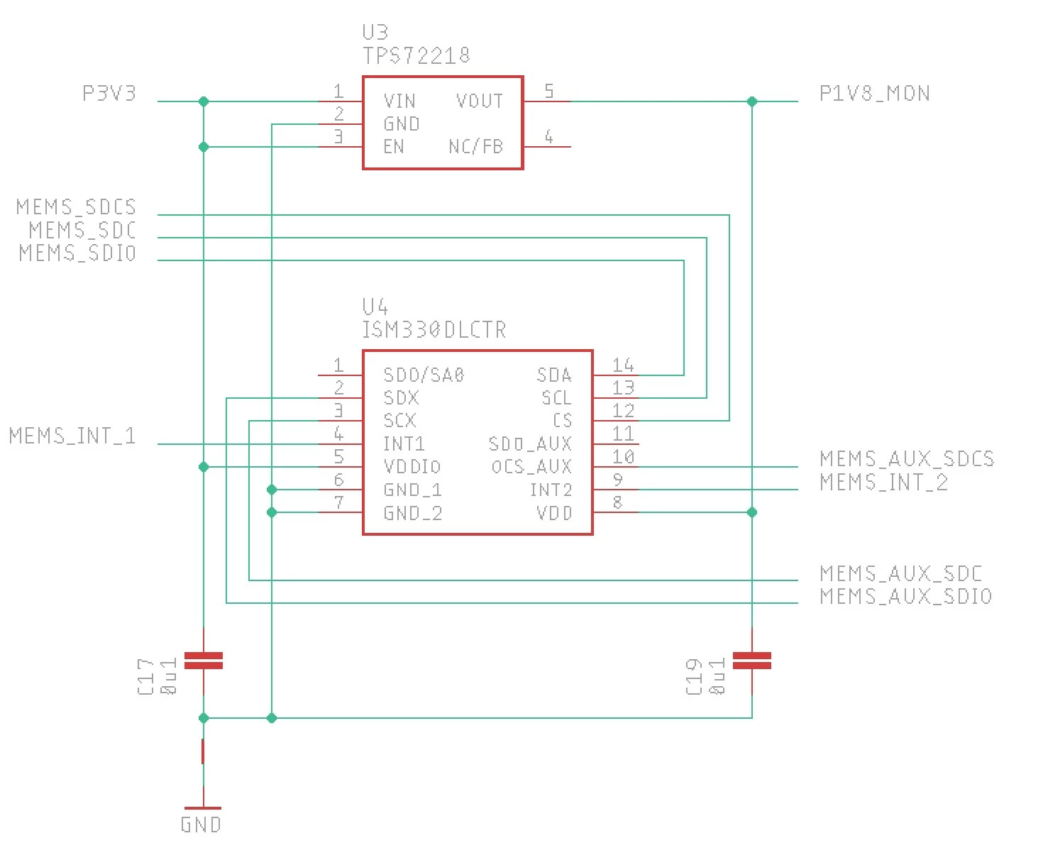

otherwise there should be problems with the board, we can check the schematic, if you want

I removed the chip and confirmed that the PCB layout compared to the following schematic.
A brand new chip was then fitted but the results were exactly the same as before i.e. no response from the chip.
My end goal is to run the chip in Mode 4 but at this moment in time the MEMS_AUX lines are open circuit.
Regards
