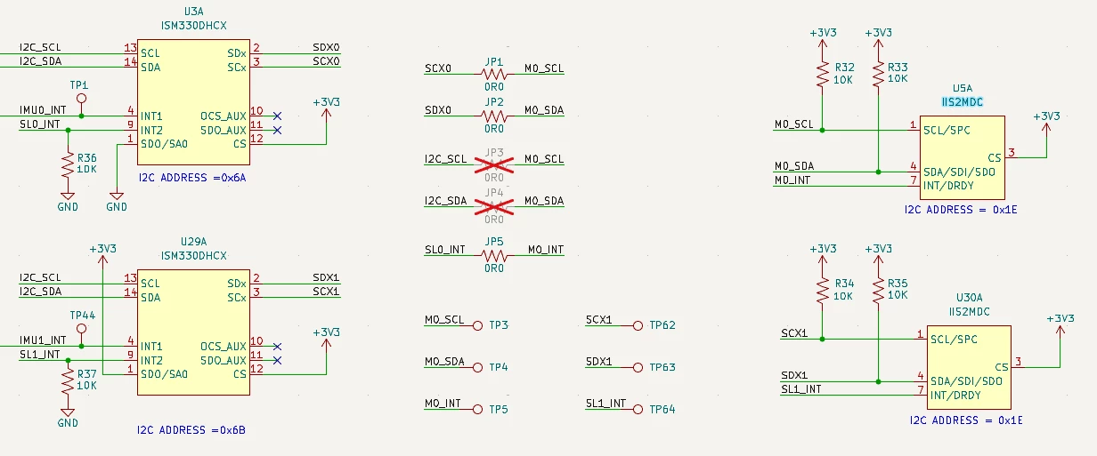

Dear sirs.
I'm connecting an ISM330DHCX with an IIS2MDC and I need to know if the connections scheme is okay to operate in MODE 2
Then I need to know if pullups are needed for i2c bus coming from SCx and SDx, and if pulldowns are required for INT lines as in the provided schematic.
I'm based on the ISM330DHCX and IIS2MDC datasheets and X-NUCLEO-IKS02A1 board manual
The routing jumpers are there just in case we need to route one magnetometer to tha main I2C bus
Thanks in advance
Ignacio

Hi @nachus001 ,
The schematic is ok. The external pullup resistors must be used because the internal resistors values are very high and they're used only to avoid floating pin value. For same reason it is better to use the pull down resistor on INT (DRDY) pin
