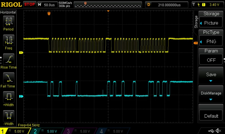

AScha.3
Aug 4, 2026 10:19 AM UTC
This is an I2C on scope:
Any spike here might disturb the data or even produce a hang up ….so check signals.
https://rheingoldheavy.com/i2c-signal-reverse-engineering/
You didnt tell : which cpu + on same board w. ground plane or free wires, how many mm I2C lines / distance to cpu  ?
→ because : random “hang up” indicates a hardware problem, probably spikes/stray-in EMI .
