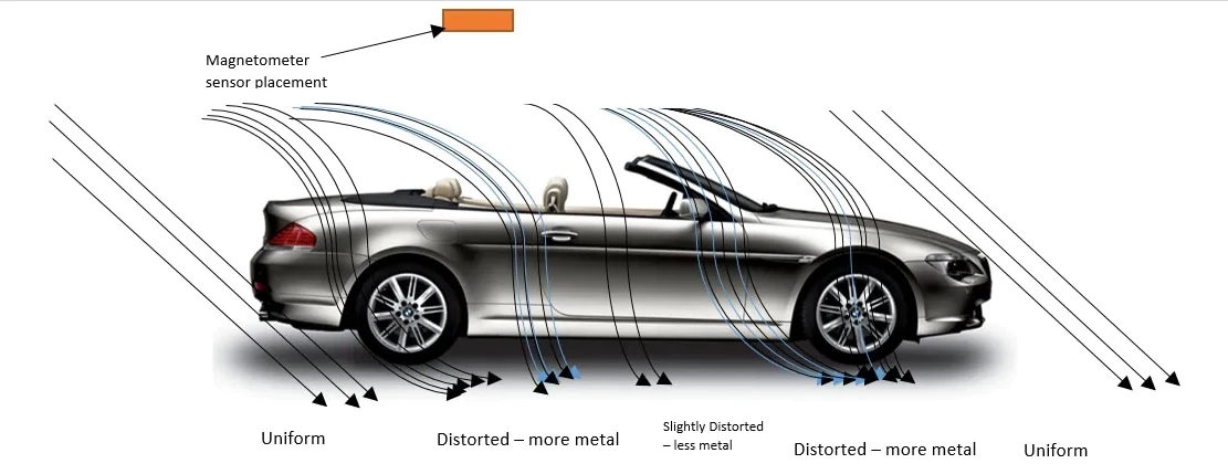

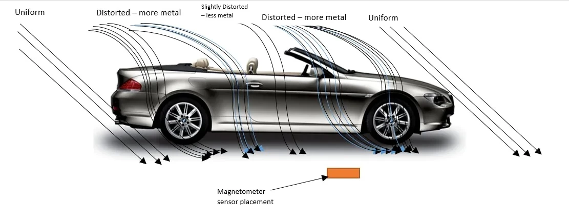

Is it possible to share user application example of ISM303DAC for design reference.
I have doubts regarding sensors placement as follows.
1) Can we place sensor in the ceiling and sense deflection in earth's magnetic field when vehicle enters/departs from below the sensor. (Please refer following images for two different cases and confirm can we use ISM303DAC in both cases)
2) Is there any limitations on ISM303DAC's functioning to detect deflection in earth's magnetic field because of multi-floor building.
3) Is there any possibility that vehicles entry / depart will affect adjacent  sensor device ?
0693W00000SuQXUQA3.jpg Case_1 Sensor Mounted on Road
0693W00000SuQXZQA3.jpg Case_2 Sensor Mounted at ceiling
