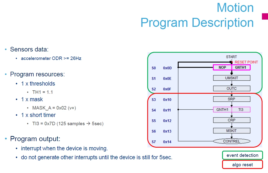

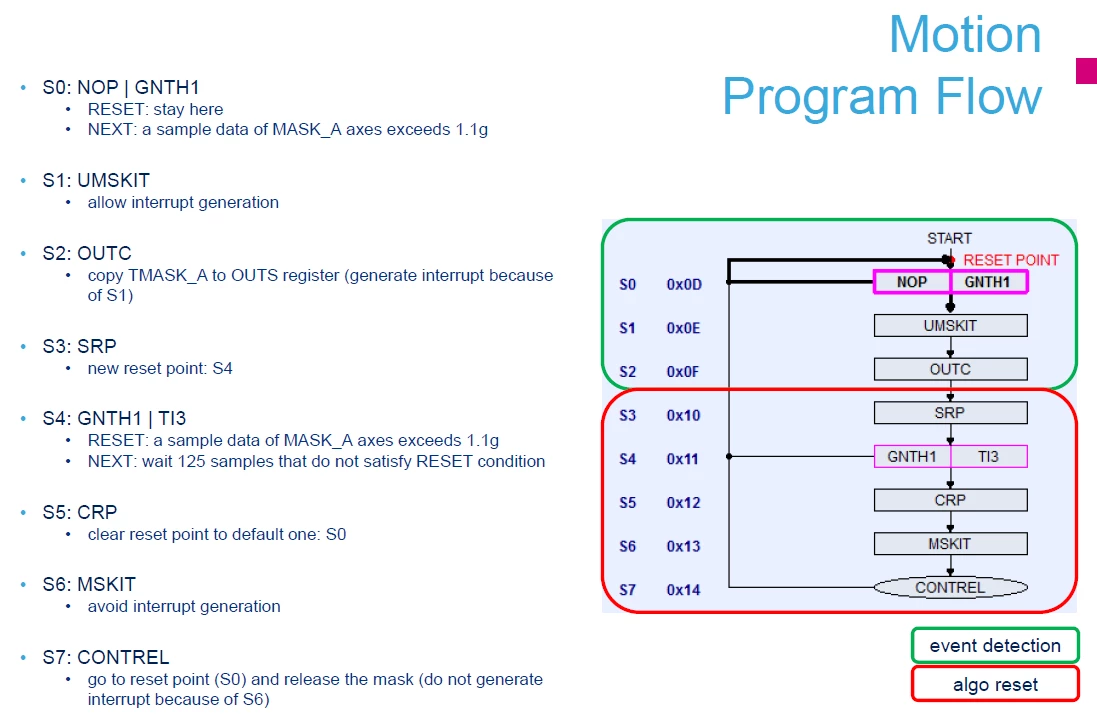

Eleon BORLINI
Apr 1, 2021 7:41 AM UTC
I believe so: this is a generic flow for motion detection.
You might have to fine-tune the threshold and the timings for taking into account a car motion instead of a person motion, but should work.
Here below I share you some more details on this FSM algorithm:
-Eleon
