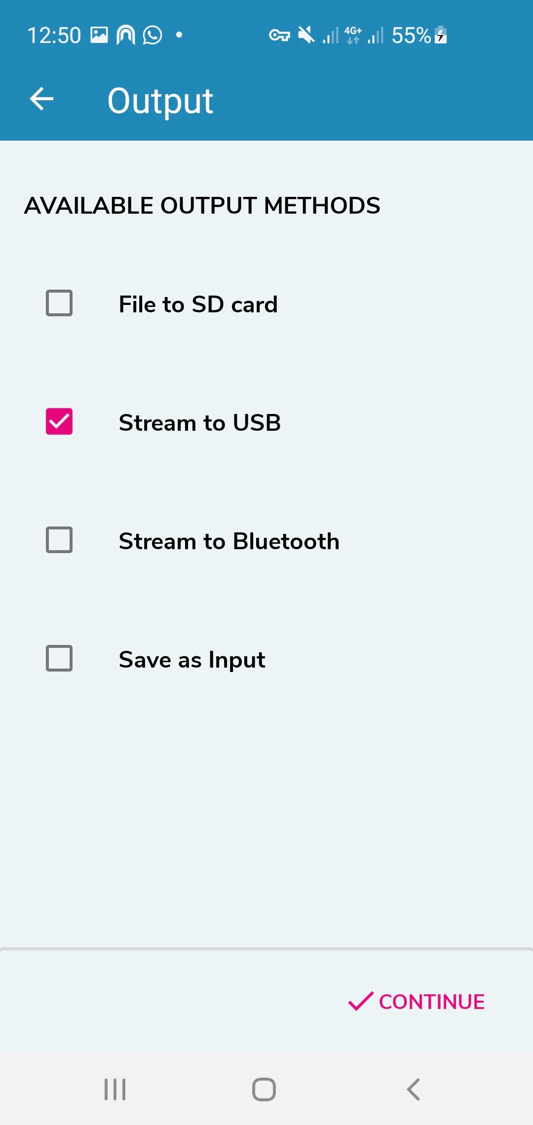

Is there a way or instructions to stream usb serial data without using the unicleo gui? For example with the datalogger example code?

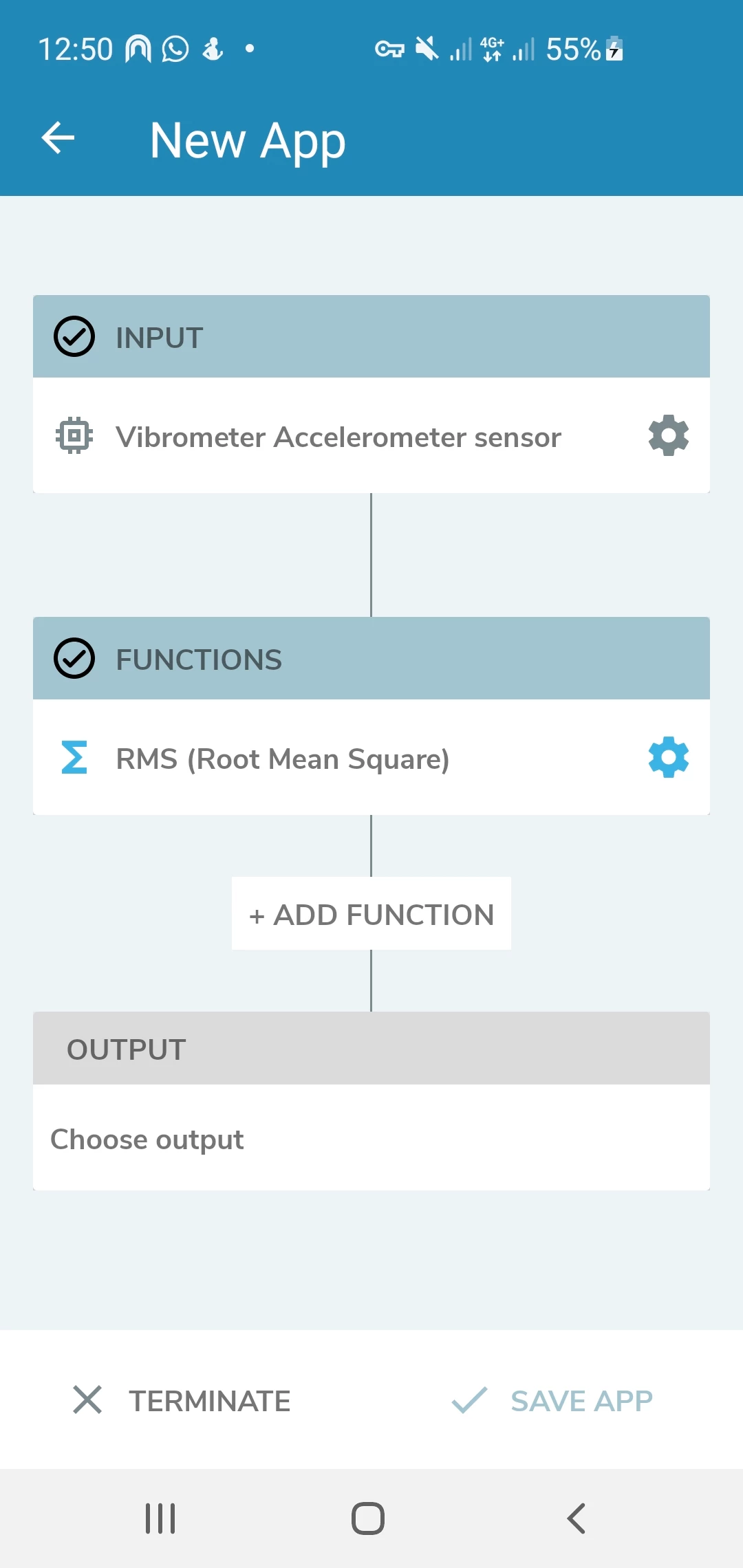

Hi @JGies.1​ ,
you can select the Stream-to-USB output from the STBLE Sensor smartphone app, Expert mode, output menu, after selecting the sensor you desire to acquire. See the screenshots below.
Please note that:
  • Virtual COM port is seen only if File to SD card has not been selected. Ejecting the virtual storage device does not help.
  • When selecting more than one accelerometer as input, remember the selection order. Column order in CSV is the same as selection order when creating the app
If my reply answered your question, please click on Select as Best at the bottom of this post. This will help other users with the same issue to find the answer faster.
-Eleon
