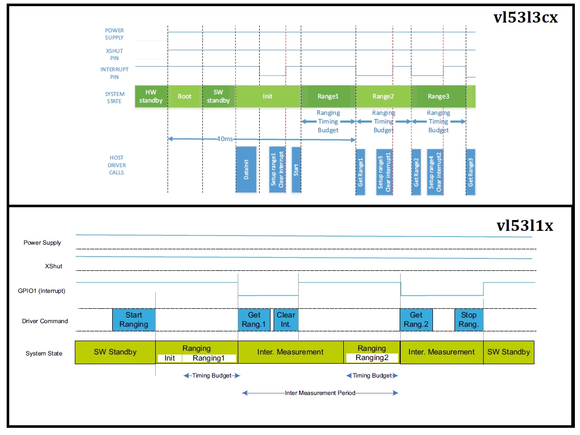

    My doubt is related to the fact that the way of managing the timing of the two ToF types seems different. I hope I can explain my problem well. I have tried two strategies to manage different VL53L3CX ToF (let's consider the case of 6 ToF).

    Both strategies are preceded by reset, set, initialization of the devices and the launch of the StartMeasurement driver function for each of the ToF.
    In the first strategy I would like to execute the flow of instructions: VL53LX_GetMeasurementDataReady (Dev [ToF], & NewDataReady) -> VL53LX_GetMultiRangingData (Dev [ToF], pMultiRangingData) -> VL53LX_ClearInterruptAndStart [ToFeasurement] one ToF at a time
    In the second strategy, on the other hand, I throw every single instruction 6 times before moving on to the next instruction.
    Both of these strategies seem to work well for small timing budgets (8-30 ms), but when setting high timing budgets the ToFs don't work well. I believe this means that I am mishandling the 6 ToFs.
    I could not verify if this also happens for the ToF VL53L1X, but comparing the two User Manuals I realized that while the VL53L3CX provide the information of the i-th measurement while the measurement (i + 1) is carried out, in the case of the VL53L1X the information of the i-th measurement is obtained during the inter-measured.period preceding the measurement (i + 1).
    Considering all this, I would like to know if the performance problem, in the case of 6 ToF, is related to different aspects of timing compared to the VL53L1X or if I did not write the code well and I did not respect the ranging flow for the VL53L3CX.
    Thanks again for answering my question
    Vincenzo

    I rewrote the code for VL53L3CX, as you advised me, based on the code written for VL53L1X. ToF performance problems no longer occur. Thanks Julien!
    However, while in the case of the VL53L1X inside the while(1){} loop I repeat the StartMeasurement() function continuously, in the case of the VL53L3CX I execute this function only once, before entering the while(1){} loop and immediately after the initialization functions. After all, if I remember correctly, within the UM of the VL53L3CX API, the ranging flow requires that the startmeasurement is carried out once and then, after choosing the preferred mode (driver/host polling or interrupt) the getData-ClearInterrupt cycle is repeated continuously.
    Thanks again.
