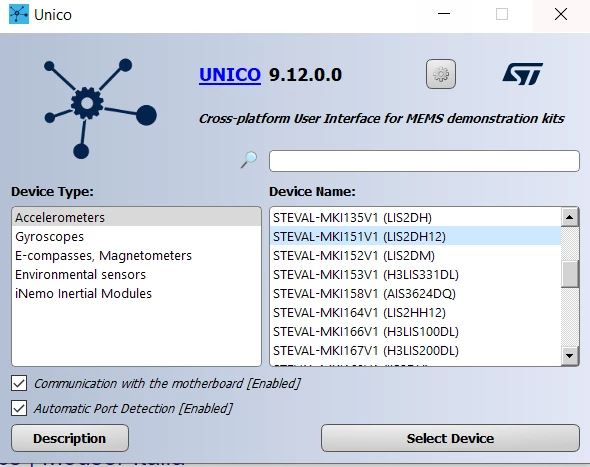

is STEVAL-MKI151V1 (Evaluation Board, LIS2DH12 MEMS 3-Axis Accelerometer) compatible with STEVAL-MKI109V3 (MEMS Adapter Motherboard)?
From the Detail, it just mention fully compatible with the STEVAL-MKI109V2
  • Fully compatible with STEVAL-MKI109V2 motherboard
    1 reply
    Eleon BORLINI
    November 17, 2022
    Hi @Ktan.1​ ,
    yes, the STEVAL-MKI151V1 is compatible with the STEVAL-MKI109V3 version.
    You can find the adapter in the list once you launch Unico-GUI.
    -Eleon
