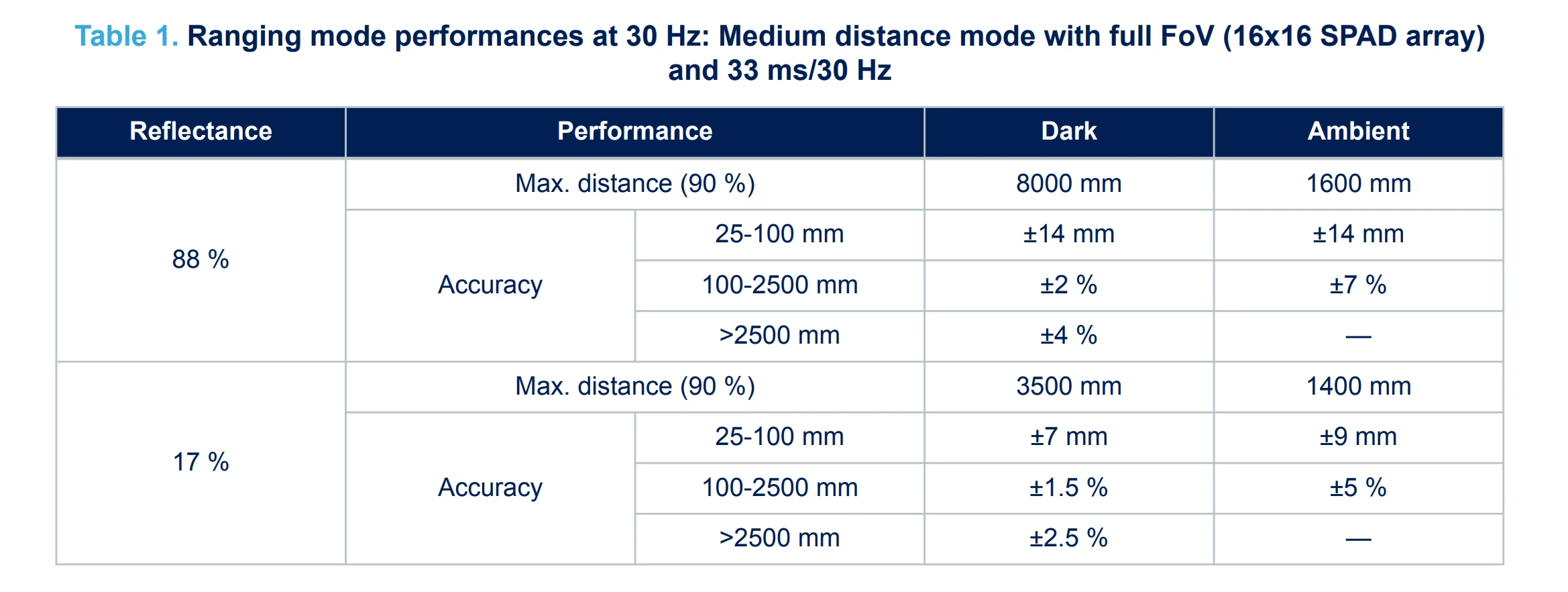

I am wondering if there is an answer to this last question: "That is, if by hypothesis I choose ToF VL53L1CB, Does its performance remain unchanged both using the ultralite driver for L1X and using the STSW-IMG019 driver?".
I am using the VL53L1CB with the VL53l1X driver and I'm just trying to get readings up to the maximum 8m range. However, it is not giving me readings greater than 4m. I don't need to use the histogram feature. How can I get the maximum ranging distance out of the VL53L1CB? I would like to use the VL53L1X driver if possible since it runs on an Arduino, whereas the L1CB driver is too large to run on even an Arduino Mega.

The VL53L1X uses what we call 'standard ranging', it uses statistics to get the answer and that answer is completely embedded inside the chip. It's max distance is 4m.
The VL53L1CB uses Histograms. Each bin of the histogram is the number of photons collected in that clock cycle. The histograms are then sent back to the host, and the host extracts the answers.
Physically the device is limited to 4M. But we have all the data in the host so we can do some additional processing. We can 'unwind' the wrap-around check and look for distances up to 8 meters. This process assumes you are looking at a very refective target - such as a projection screen. (It well may be that a projection screen is the only thing large enough and reflective enough to actually go 8M. But that's the use case we were solving.)
It's the host processing that gives you the far distances. And it's why the host processing is larger than the ULD.
You say that you don't need the histograms, but it's only the histogram proessing that will give you those far distances. Histograms and a large, reflective target that is.

Hi John,
Thank you very much for explaining the significance of the histogram feature in reaching the maximum distance. Therefore, if I were to implement the VL53L1CB API, I should be able to read measurements up to 8m at 30 Hz (33 ms timing budget) as specified on Table 1 of the Ranging Mode Performances document for the VL53L1? Also is it a typo that it says that it will read the maximum distance under Medium distance mode? Because in other documentation it says that the Long distance mode is necessary to obtain the maximum range.
