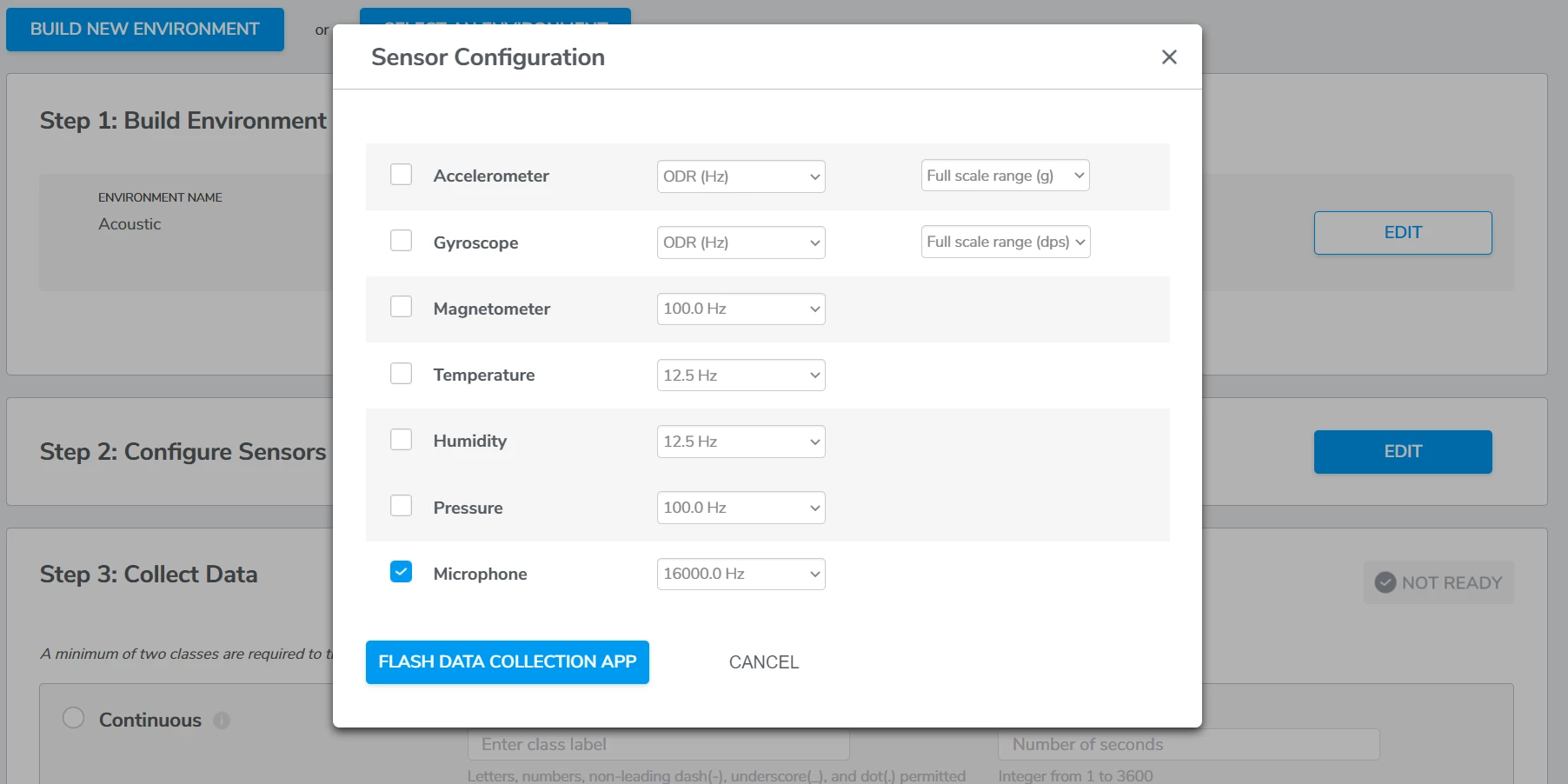

Is it possible to do wake word detection on SensorTile Box?
    Eleon BORLINI
    Eleon BORLINIBest answer
    October 28, 2021
    Hi @ShivaRagu​ ,
    I believe it is possible, even if not so straightforward. You might refer to the general solution provided by ST, that however runs on STM32H7, while the Sensortile.box supports STM32L4: I'm referring to the STEVAL-VOICE-UI Voice User Interface reference design kit.
    Another possible solution, directly involving the Sensortile.box tool, can be use the Qeexo ML tool: this allows you to run many kind of neural networks on the audio acquisition from the analog MEMS microphone on the Sensortile.box tool.
    -Eleon

    ok thanks, is there any function pack for Stm32h747i-Disco board?
    Eleon BORLINI
    November 2, 2021
    Hi @ShivaRagu​ ,
    The STM32H747I-Disco is unfortunately not directly configurable with the Qeexo ML tool.
    You might try to adapt the STEVAL-VOICE-UI tool to the STM32H7-Disco, since they both mount an STM32H7, but I'm afraid it is not a straightforward task.
