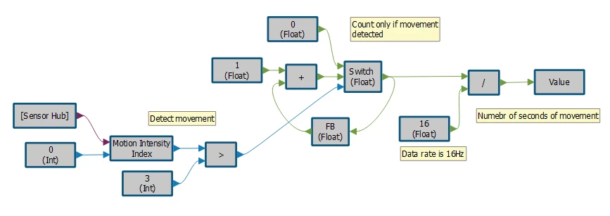

Is it possible to create a timer in Algobuilder that can be reset based on movement?
I would like to be able to create a timer that counts time elapsed during an activity and resets when the activity stops. Any suggestions on how to do this.
    Miroslav BATEKBest answer
    Nov 23, 2020 5:44 PM UTC
    It can be done for example like this:

    Thank you Miroslav,
    Your example is exactly what I needed to help me move forward with my project.
