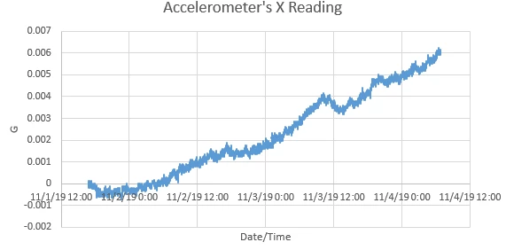

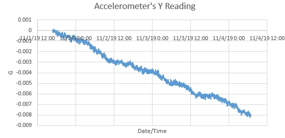

Is accelerometer drift in the LIS3DSH normal behavior?
I have an LIS3DSH securely mounted to a stationary object away from any vibration. Over the course of two and a half days, I've found the readings slowly change in value. I've tried this with multiple accelerometers (all LIS3DSH) and they always show similar results of drift.
Here's an example: It changed by about 0.006G on X, 0.009G on Y and .05G on Z. The graphs of change are shown below. Anyone have any ideas?

One additional thing: Note that the magnitude drops over time as well. Ideally is should always be 1. Looking at the data graphed below, it starts at 1 and continually drops over the course of the two and a half days.
