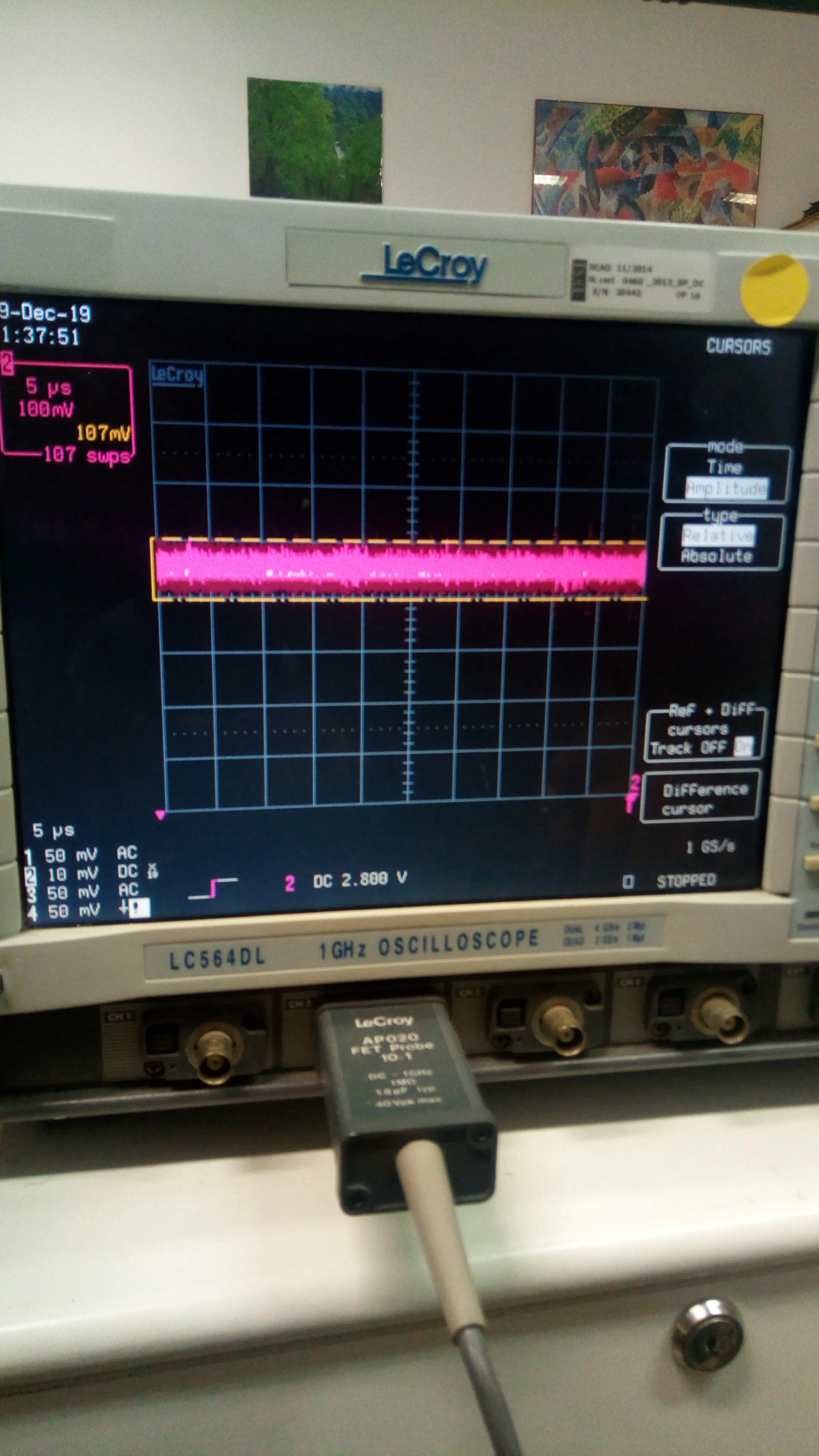

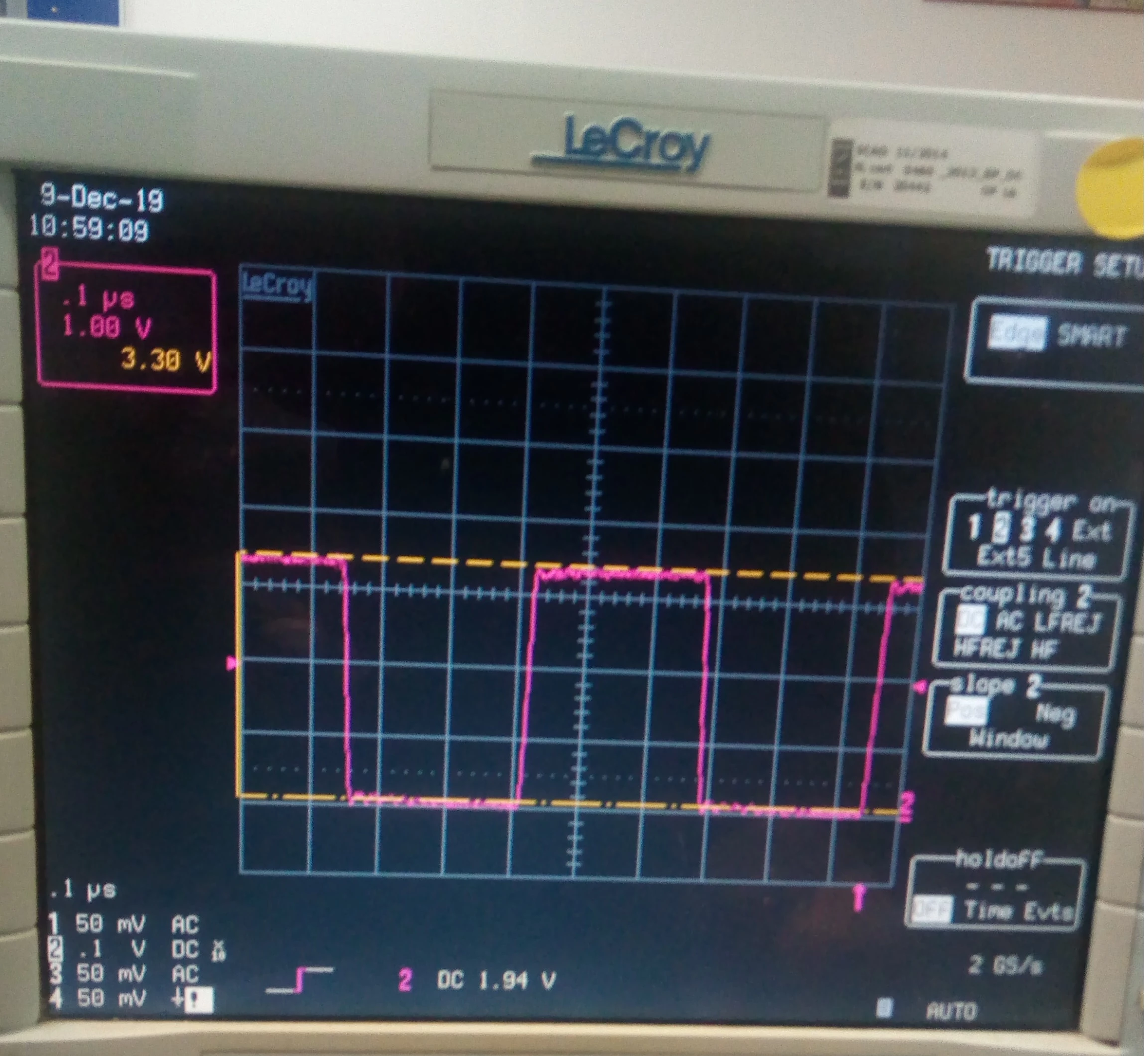

Dear Eleon,
thanks for the answer.
I confirm that they are 10 seconds.
We have checked power supply and provided clock and they seem in the feasible range.
Voltage is 3.3 Volts (see the screenshot of the range around 3.3 )
and the clock is stable on the value of about 2 MHz immediately after microcontroller initialization
(see attached screenshot from scope).
