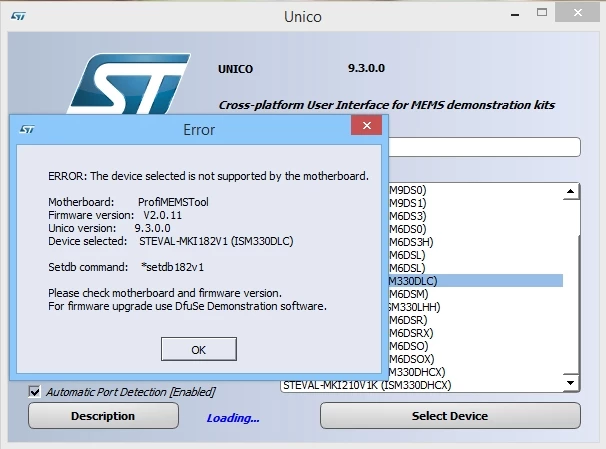

Hallo to All,
we would like to put the ISM330DLC into a new product in developing, in order to evaluate in REAL TIME the overall vibrations in order to keep the operator in the SAFE OPERATING AREA.
The tool is an electrical manual tool, an orbital sander.
We are currently evaluating many accelerometer using UNICO FFT analysis, and we would like to evaluate the performances of the ISM330DLC, but unfortunately the FW inside the eval does not support this device.
do you know if there is any chance to update the FW in order to make the adapter working with ISM330DLC mounted on MK182V2.
Thank you very much for your attention

    Hi @FCern​ , thank you for the description of the user application. I see your FW version is not updated (2.0.11 instead of e.g. the attached revision)... can you please update the MKI109V3 FW and then try again the connection?
    Regards

    Hi Eleon,
    thank you very much!
    We have just done the UPGRADE and now the MKI109V3 works perfectly with the ISM!!!:thumbs_up:
    Thank you again!
    Best Regards
