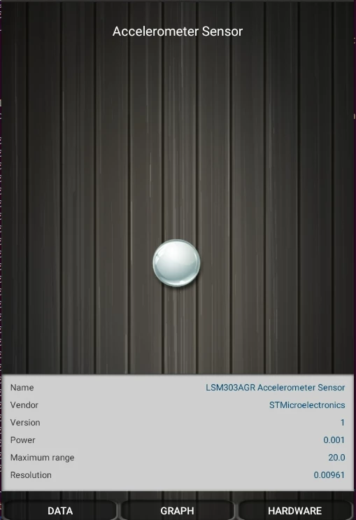

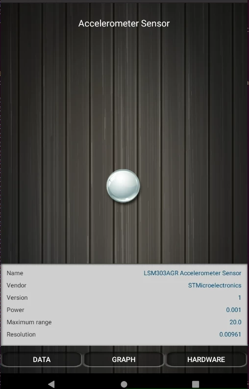

Feb 21, 2025 2:28 PM UTC
Yes you are true, interrupts are getting incremented. kindly find the attached files there are no implementations for loadbias and savebias in legacy mode
legacy/SensorsLegacyInterface.cpp
247 * onSaveDataRequest: receive data to store,
248 * reference: ISTMSensorsCallbackData class
249 */
250 int SensorsLegacyInterface::onSaveDataRequest(const std::string& resourceID,
251 const void *data, ssize_t len)
252 {
253 (void) resourceID;
254 (void) data;
255 (void) len;
256
257 return -EIO;
258 }
259
260 /**
261 * onLoadDataRequest: load data from disk,
262 * reference: ISTMSensorsCallbackData class
263 */
264 int SensorsLegacyInterface::onLoadDataRequest(const std::string& resourceID,
265 void *data, ssize_t len)
266 {
267 (void) resourceID;
268 (void) data;
269 (void) len;
270
271 return -EIO;
272 }
Feb 21, 2025 2:29 PM UTC
Feb 21, 2025 2:31 PM UTC
Kindly help
