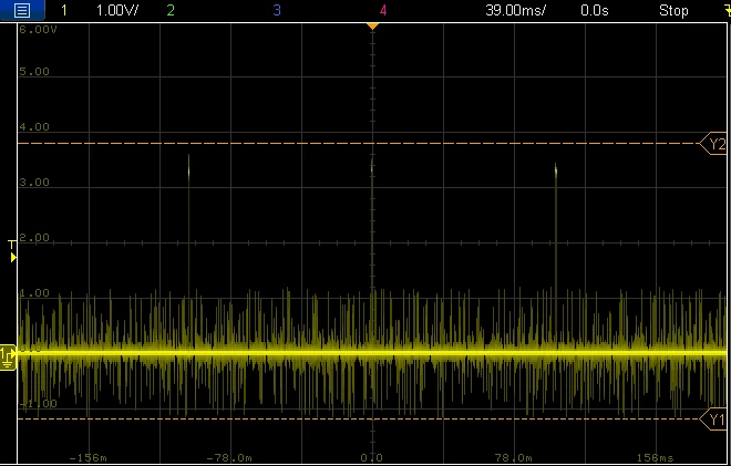

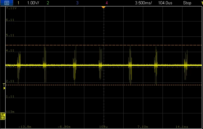

HTimm.1
HTimm.1Author
Sep 3, 2020 10:55 AM UTC
0693W000003QfMqQAK.pngHello,
on scope i can see something on the interrupt pin.
But it is no clear signal.
After each SPI communication i do a pause.
The longer the pause the longer the spaces on the scope.
 Here i can see that the measure is done every 100ms (10 Hz).
INT1 does work. But the signal is very ugli for low signal.
