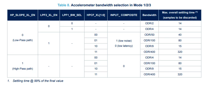

In ISM330DLC, is odr equals to smaling frequency? if not how to calculate the sampling frequency to calculate the FFT

    Hi, the maximum bandwidth is equal to ODR/2 (if no filter is applied on the acquisition chain), as for Nyquist theorem.
    You can fin the description of accelerometer max bandwidth (i.e. maximum detectable frequency) at p. 13/14 of the AN5125

    Hi Eleon,
    Thanks for your quick response.
    We will check if we can validate the data by using ODR/2 as sampling frequency.(If no filter used) and respond here.
