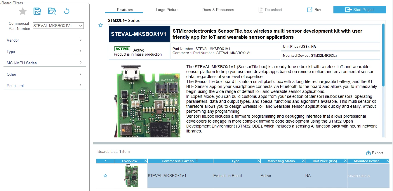

In Cube MX there are two software packages (XcUBE-BLE1 and XCUBE - BLE2) which to use for the Sensortile.Box and Sensortile Development Kit. STEVAL - MKSBOX1 has SPBTLE and STLKV101 has BLUE NTG Chip .

Hi @Snara.2​ ,
consider that the X-CUBE-BLE1 includes drivers for BlueNRG-MS/BlueNRG-M0 Bluetooth low energy devices, so it is suitable for the STEVAL-STLKT01V1.
On the other side, the X-CUBE-BLE2 will be ok when the Sensortile.box will host the BlueNRG-M2 module, but for now you should use the FP-SNS-STBOX1, that and includes the drivers for the STPBLE-S1. In this case, if you want to start from scratch with the CubeMX, you can access the board selector and select the SensorTile.box tool.
