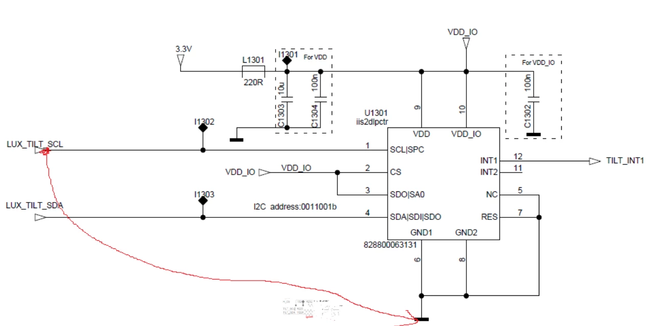

For special test case, that directed connected IIC's SCL(LUX_TILT_SCL) to GND and kept for 5mins, will this action hurt or damage IIS2DLPC?
IIC worked with 100kbps.
Work with IIC.

Grounding SDA or SCL will not hurt the chips, but it will prevent communication from taking place. SDA/SCL are driven with open drain, so pulling them down doesn't cause hardware issues.
Use a logic analyzer to see what's happening on the line.

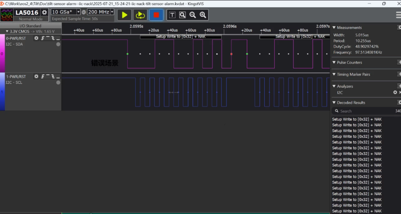

With logic analyzer, after 5mins ground SCL, the chip randomly cannot response with IIC even remove SCL grounding.
No response could not recover even cold reboot the chip.

For another abnormal behavior after 5mins grounding SLC, the axis data was incorrect, confirmed with logic analyzer.
When sensor was steady state on a horizontal surface, X-axis reached 1000mg. X-axis should be around 0mg.
