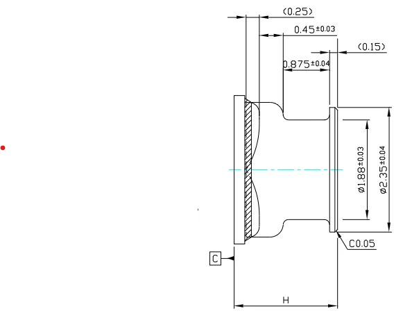

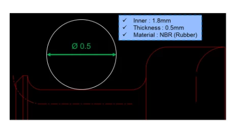

I'm having a hard time to find a supplier for an o-ring to get the ILPS28QSW sensor waterproof.
In AN5937 ST mentioned they use an o-ring with: ID 1.8mm, thickness 0.5mm (see picture below)
Does anyone here know any supplier who make these, or have used another size with good results? For example if a thickness of 0.75mm would work? I'm afraid the o-ring might be to big?
And FYI: The cylinder formed hole for the sensor is very similar to the one ST is using in AN5937
O-ring from AN5937:
Dimensions of the ILPS28QSW from the datasheet:

What has been highligted in the AN5937 is an example using NBR  with 70 hardness. It is mandatory don't exceed the limit of internal diamenter (greater than 1.8mm) and o-ring diameter (less than 0.88mm) to avoid to damage the groove of the device. Possible o-ring maker could be: Wurth or O-rings.

I'm having the same problem.  AN5937 indeed has the dimensions for the o-ring (see Fig. 3).  1.8mm inner diameter, 0.5mm cross-section diameter.  The smallest standard cross-section diameter is 1mm (from these tables).
Who makes the appropriate non-standard o-rings?  What o-rings were you using at ST when you were qualifying the sensor?  Please post the suppliers and the part numbers.

I found a supplier in europe, M-seals, who has the o-ring ST suggested: Their p/n: 1017340
FYI, I ended up ordering a custom made o-ring with another material but same dimensions, and at least in my case I had to order at least 250 pcs and the leadtime was 8-10 weeks.
I also found a supplier in the US who also seems to manufacture o-rings in this dimension: https://www.applerubber.com/
For ST:In my opinion you should update AN5937 at page 4
"The following commercial O-ring can be used as a reference..."
Which I find misleading since apparently it is quite hard to find an o-ring in the dimmensions you are suggesting.
