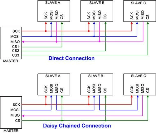

August 11, 2023
There are I2C bus multiplexers, but due to the high number of sensors, possibly the only alternative is to operate with SPI (daisy chained connection).
https://www.digikey.be/nl/articles/why-how-to-use-serial-peripheral-interface-simplify-connections-between-multiple-devices
RhSilicon
Lead
August 11, 2023
I found this document that might be interesting to see:
Daisy Chain Implementation for Serial Peripheral Interface
Another option could be to use SPI in direct mode with 74HC595 to control the SS pin, need to observe the characteristics of Fan-in/Fan-out:
https://efficientcodeblog.wordpress.com/2017/11/03/what-are-fan-out-and-fan-in/
