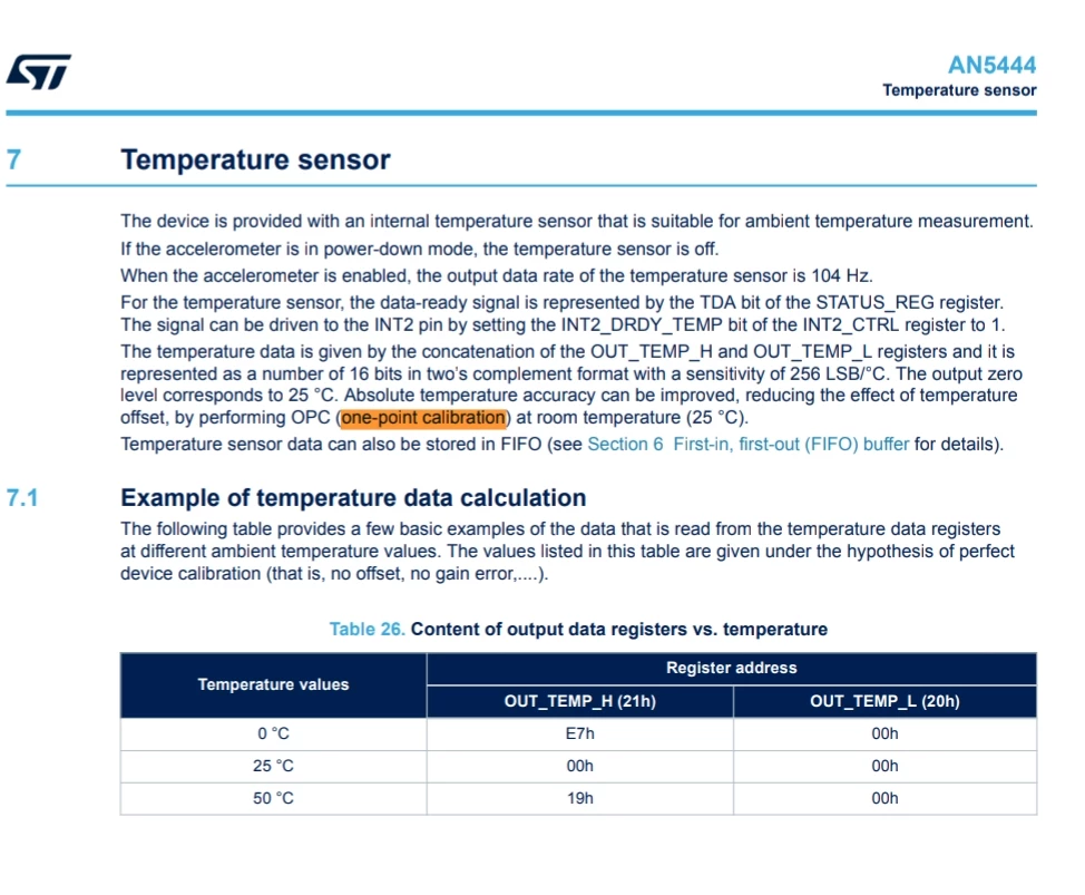

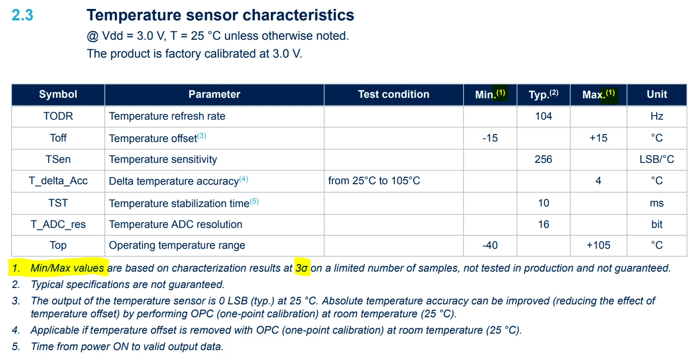

In the IIS3DWB datasheet, it is said that the embeddeed temperature sensor offset can vary within a [-15°C : +15°C] range.
Does that mean that the reading from OUT_TEMP_H/L can vary within [-256*15 LSB : +256*15 LSB] at 25°C ?
Having tested 2 chips myself, I got a much better result.
I am then wondering whether I was just lucky, and if I really need to calibrate.
Thanks

Hello @pb38
I suggest you to perform a one-point calibration to increase the accuracy of your sensor as mentioned in the datasheet. You can take a look at this exemple:
After that, you can see that the accuracy of your system increase.
Best regards.

Thanks for you answer,
I did not want to calibrate, but il looks like I will have to do it anyway. At least I will not have to calibrate the sensor sensitivity.
September 14, 2023
Mind the footnote which explains what min/max means here. 3σ is a wide bin, and most of the time you're going to be in the middle third (so ± 5° C). And 0.3% of samples will be outside of that bin, so no guarantee you'll even be within that range.
Also note that even after calibration, you can have ± 4 °C over the full range. The focus of this chip is accel/gyro, not temperature.

Thanks for your answer.
The 2 chips I have tried are within 0.2°C (probably from a same lot), but I looked closer and their offsets are approximately -2.5°C, and I cannot afford that much.
I think I was in denial, hopping for an error in the datasheet, as ±15°C looked very big to me. It could have been ± 15LSB instead...
I guess I will have to calibrate then, it is a shame ST does not do it for us.
Issamos
September 15, 2023
Is always better to do the calibration by yourself. It can depend on your environmental conditions, your use case,... . So, is not going to be really efficient if it is done in the same conditions for everyone.

Hi @pb38 ,
If you want an accelerometer more accurate in temperature, I suggest you to use the LIS2DTW12 sensor.
Otherwise, you need to implement an OPC at room temperature (25 °C).

Hi @pb38 ,
Our devices with 6kHz bandwidth have a temperature offset min-max of ±15DegC, however, as suggested by @TDK , if ±2.5DegC is too much, you should choose a dedicated temperature sensor.
