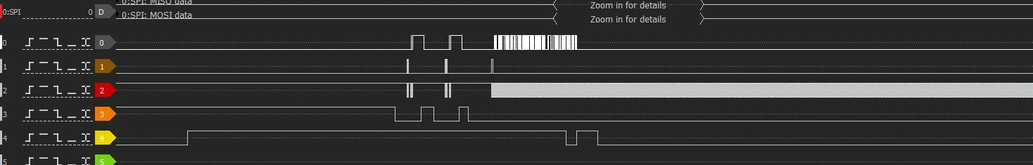

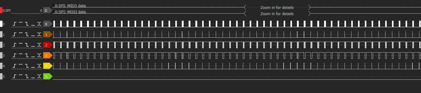

As you can see from below the FIFO threshold is triggering the interrupt correctly and the uC is reading the contents of the FIFO quickly enough to avoid any sampling lose.
MISO - 0
MOSI - 1
CLK - 2
CS - 3
INT1 - 4
If I allow the IIS3WB to sample for approximately 8+ mins, I’ve observed that the interrupt stops triggering and hence the uC no longer reads back any entries in the FIFO. Sometimes this test could run until 50+ mins before stopping.
On closer inspection, I noticed that the last interrupt seems to have a ‘blip’ and at that point the data being read back from the FIFO is 0s. Previously the interrupt would have remained high for longer.
Further debugging shows that SPI communications are functioning correctly afterwards . I can read back the contents of the WHO_AM_I register perfectly but when I read back the contents of the control registers, the values are all 0’s. It is possible to write to those registers again.

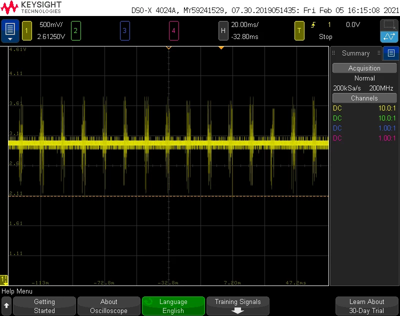

    With a scope I was able to observe some noise on the Vdd and Vddio lines (see below)
    0693W000007E6vTQAS.pngWith sitting around 3.0V there are times when it could get pulled lower than the 2.1V of the IIS3DWB.

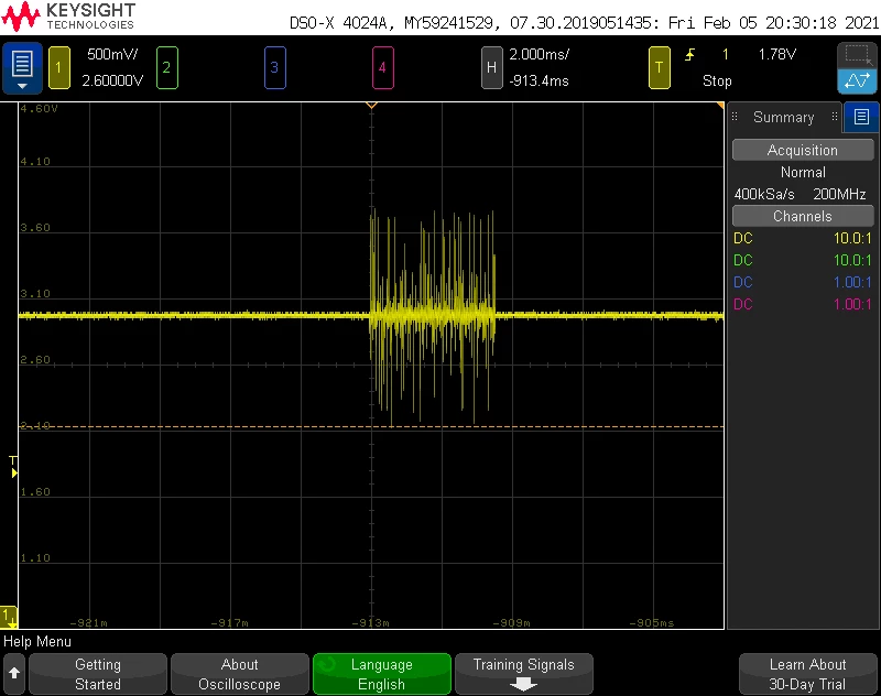

    When the IIS3DWB is not sampling, the Vdd and Vddio are clean. Further investigation resulted in disabling the interrupt and reading the FIFO periodically (1 second)
    When we did this test we noticed that the noise appeared for the same time as the SPI CS was low i.e. ~3.6ms
    0693W000007E6yIQAS.pngAs I mentioned in the original message, this isn't the intended HW and there are wires between the IIS3DWb eval board and the target uC. For now we think we will wait until the intended HW arrives to further investigate but if you have other suggestions that would be worth trying ahead of the hardware arriving I'm willing to try them.

    Eleon BORLINI
    February 5, 2021
    Hi John @JDoug.1​ ,
    thank you for your detailed feedback. please note that from the datasheet the supply voltage range is 2.1 V to 3.6 V.
    Did you placed the decoupling capacitance on Vdd and VddIO lines, as illustrated in the datasheet p. 24 and, for example, on the STEVAL-MKI208V1K schematic?
    -Eleon
