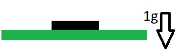

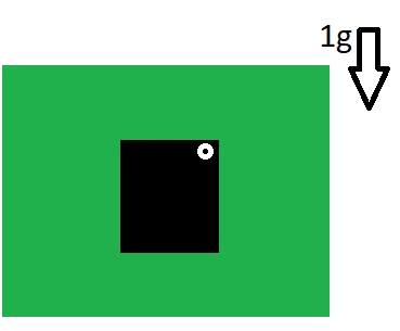

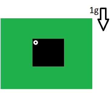

The accelerometer is horizontal, in the Z axis 1g and I have about 500 mg in the X axis. I have 3 pieces of accelerometers and in similar positions I have different readings from the X axis.

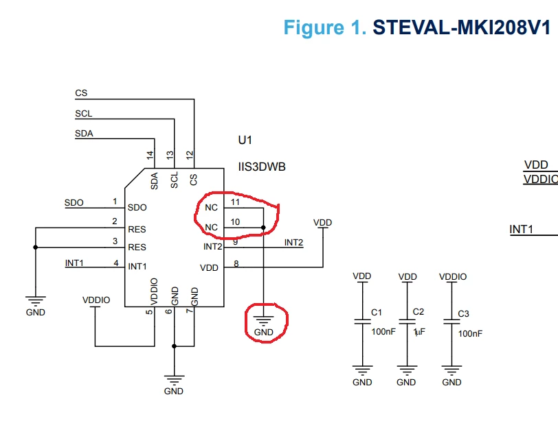

I found a certain inaccuracy:
in the documentation:
0693W000005Bk2KQAS.png in the evaluation board:
0693W000005Bk2CQAS.pngcould this be the cause of the error? I also have an evaluation board and it works ok.

    Hi @PSzym.3​ ,
    your finding (the fact that the datasheet and the adapter schematic are showing different configurations for those pins) is correct, but there is no difference/effect of this on the data-out of the IIS3DWB devices.
