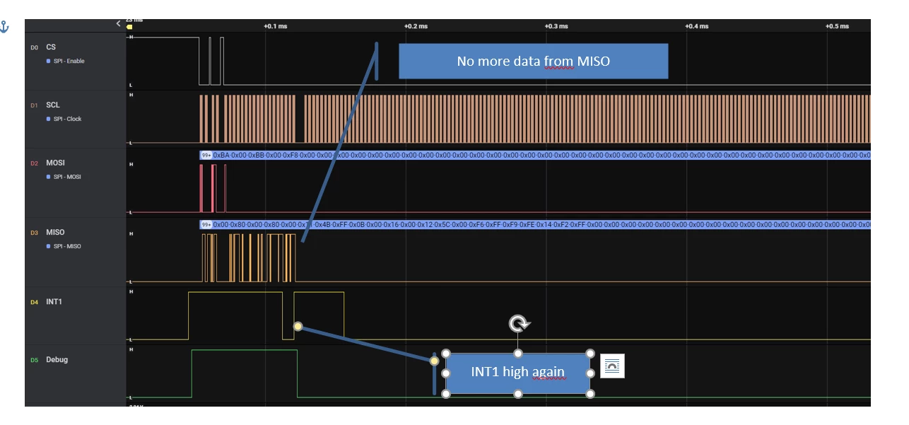

I am using an IIS3DWB mems for continuous acquisition.
So I configured it to use fifo and interrupt.
But, during transfert, I see INT1 going high, and transfert aborts.See Capture.png.
Please find IIS3DWB configuration in Config.c, is it good?
Thank you for help
