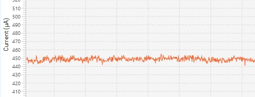

I find myself experiencing the same problem with current consumption. I my case the excess current consumption is around 250-1500uA.

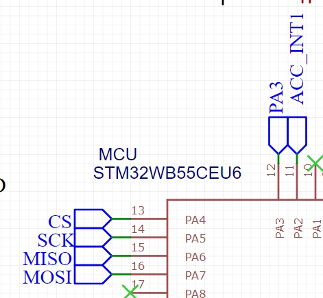

I'm using the STM32WB55CE MCU running a BLE application which controls the IIS3 though SPI1. While developing I'm using the STEVAL-MKI208V1K kit.
The application is using FreeRTOS tickless idle in STOP2-mode (I know from the MCU manual & ST presentation that the SPI is affected by this, but control haven't been an issue yet.

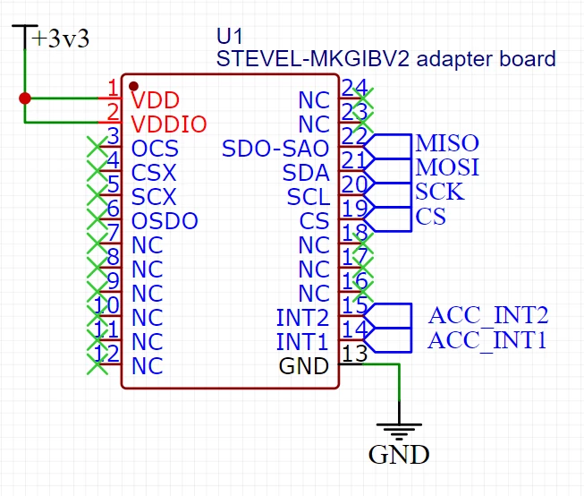

Relevant part of schematic:

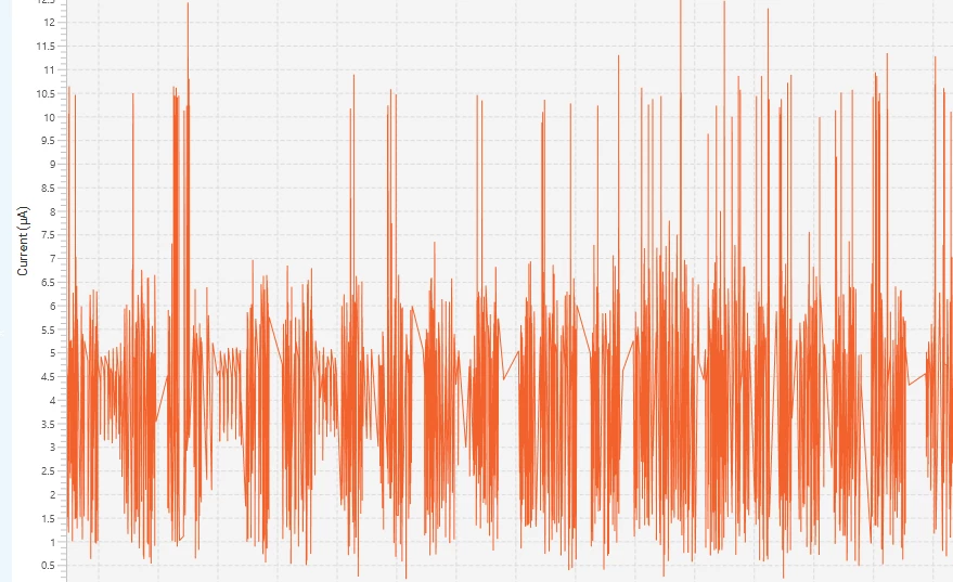

I've made a few measurements using the X-Nucleo-LPM01A board:
Consumption of board without the IIS3:

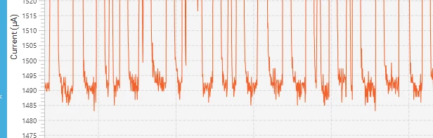

0693W00000NshJBQAZ.pngConsumption of board + IIS3-kit - IIS3 in full power mode:
0693W00000NshKTQAZ.pngConsumption of board + IIS3-kit - IIS3 in low power mode:

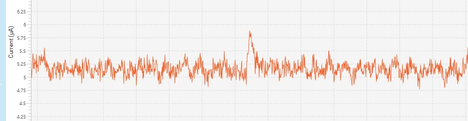

0693W00000NshKJQAZ.pngConsumption of IIS3-kit alone - IIS3 in full power mode:

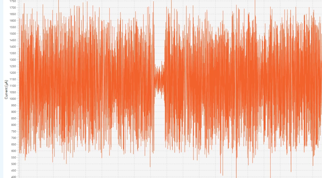

0693W00000NshLlQAJ.pngConsumption of IIS3-kit alone - IIS3 in low power mode:
The Ampere increase when turning on the IIS3 fits the datasheet very well, but I'm confused what is drawing ~440uA in the 3rd graph...
My best guess is something SPI related, but not sure what...
Any ideas or hints?

In my case, shutting SPI peripheral down AND executing any code in the Errata worked. Shut SPI down?​
KMeld.1
June 24, 2022
Shutting down SPI (HLA_SPI_DeInit() ) tkaes it down by ~90uA, so that will definitely be part of my solution as well. I will keep digging and get back asap.
