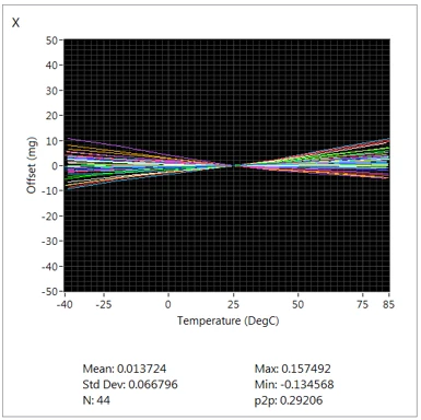

  1. For a tilt sensing application, I'm more concerned with temperature effect on the offset (not sensitivity which you discussed earlier). In the datasheet, it's listed as 0.4mg/C after the temperature compensation bit is enabled. I'm wondering what kind of temperature compensation is done here. For example, you measure offset at two temperatures and then derive an offset value to use in internal compensation. Can you provide a plot of the unit's typical offset vs temperature? The motivation is that if the curve is linear, then we can do simple additional calibrations to make the sensor more robust across temperature.

Eleon BORLINI
March 31, 2020
Hi John, I try to answer to your question here below.
  1. Can you provide a plot of the unit's typical offset vs temperature?
You can find a plot of the X axis here below, from characterization data. Similar plot for the other two axis. the drift is inside +-0.2mg/°C
