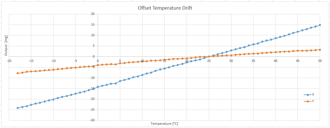

The datasheet reports an offset drift TCOff of max. 0,4mg/°C.
We made temperature tests with 3 samples and found the offset drift beeing 0,17 ... 0,58 mg/°C so higher than allowed. Does this meet your expectations?

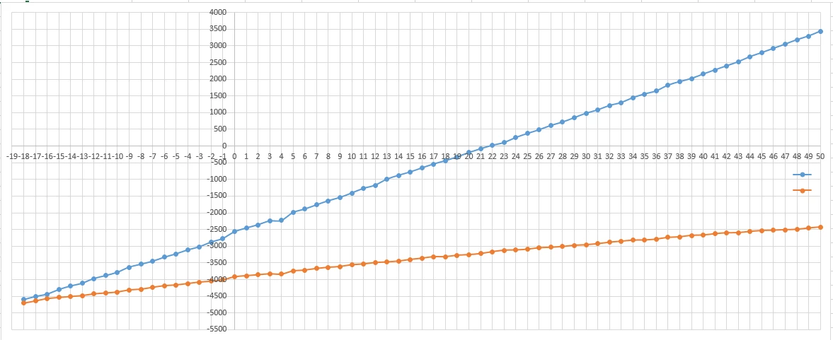

    Here our meassurement. It shows the deviation in arcsecs over the temperature in °C.

    The blue curve is X-axis; the red curve is Y-axis.

    So you are plotting the LSB on y axis? Can you please convert them in mg according to the 0.076 mg/LSB sensitivity?
    If I well understood, you found 1 on 3 devices with a TCOff of 0,58 mg/°C... this might be correlated also to the Vdd = 3.3V, which is different from the 2.8V of the datasheet and could increase internal heating.

    Hi Eleon,
    find attached the plotted drift with mg on y-axis.

    thank you for the data. Are you sure it is a IIS3DHHC device (with the final "C")?
    By the way, what if you calculate the drift (TCOff) of the overall acceleration vector, i.e. sqrt(ax^2+ay^2+az^2)?
    I have to check internally, but the TCOff parameter on the datasheet might be referred to this joint value...

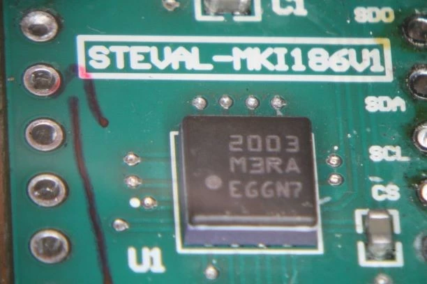

    we use evaluationboards. See attached picture.
    How do you determine the revision "C"?
    Can't find any information in the datasheet.
    Gerhard

    I was just comparing the title of your post where you wrote "IIS3DHH" and the actual device that is, correctly from your picture, a IIS3DHHC.
