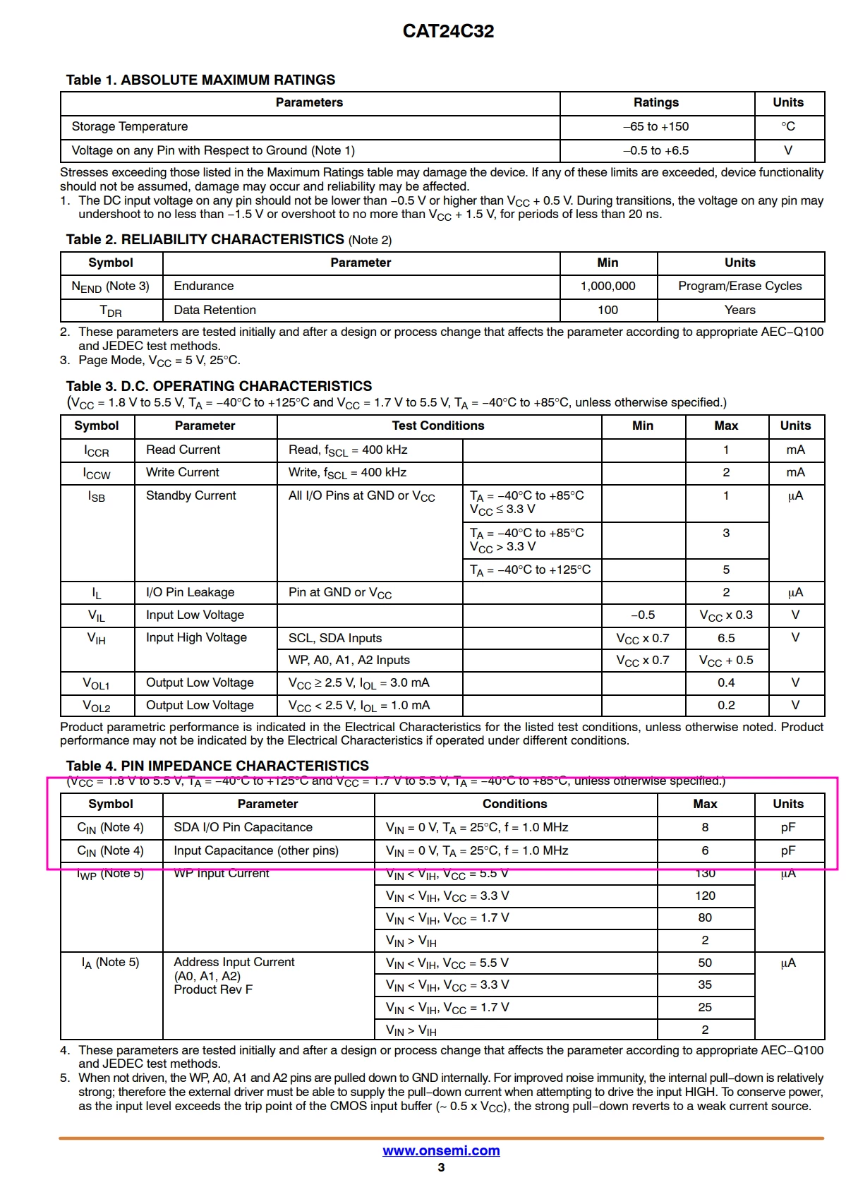

Hi Federica,
May be I didn't phrase that correctly, I mean: how much is the input capacitance of the SDA and SCL pins themselves at IIS2DLPC?
for example, here is the spec for an eeprom:
Federica Bossi
September 7, 2023
Hi @Alejandro Bizzotto_65856 ,
Got it. Unfortunately we can't provide this information, it is reserved.
