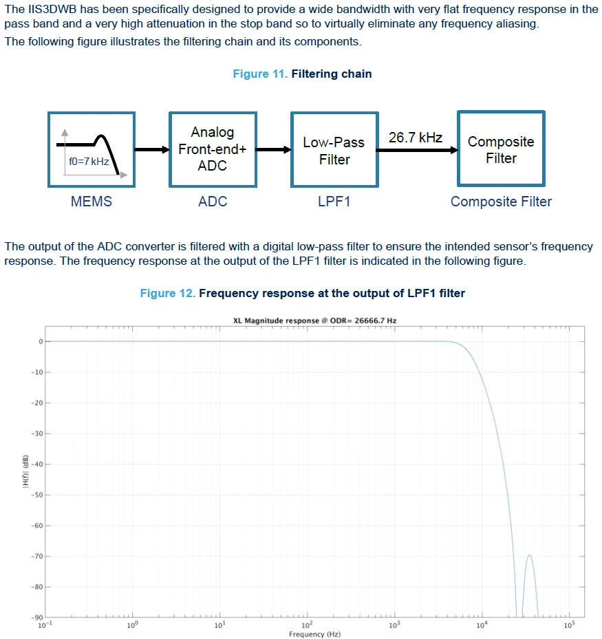

For the IIS3DWB, the data sheet offers a frequency response curve at page 19 and regarding aliasing the following information (see IIS3-Block-Diagram-Frequency-Response.PNG):
"The IIS3DWB has been specifically designed to provide a wide bandwidth with very flat frequency response in the
pass band and a very high attenuation in the stop band so to virtually eliminate any frequency aliasing."
1) So for the IIS3DWB their is no "true" analog low pass filter before the ADC in order to prevent aliasing, its simply done by the frequency response of the senor itself right? Because the LPF1 is a digital low pass filter, in theory not capable of preventing aliasing effects.... Or am i on a wrong direction :) ?
2) Does the frequency response for the IIS2DH provides a low pass curve progression by the sensor itself too in order to eliminate aliaising, simillar to the IIS3DWB?

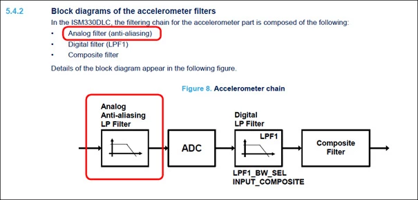

    I would expect a signal chain for the IIS2 and IIS3 similar to this one....0693W000007DmSbQAK.jpg

    Hi Joe @FPal.1​ ,
    No, there is no analog anti-alias filtering just before the ADC of the IIS3DWB and IIS2DH.
    In both cases, the mechanical structure of the accelerometer MEMS sensor acts as a low pass filter, preventing a significant fraction of the aliasing issue.
    The fact is that the anti-alias filter is -at a practical level- limiting the bandwidth of the sensor, and for the vibrometer having a broad band (up to the 7kHz resonance frequency) is fundamental.
    -Eleon

    thanks for your quick reply ;) I had thought so that the mechanical structure of the accelerometer would act as a low pass filter. But for me it was important to have this confirmed again, thx.
    Am I correct that LPF1 for the IIS3DWB is neccessary to limit the signal bandwidth on less than the resonance frequency of the sensor axis? Because an actual gain caused by resonance is not desirable and could be misinterpreted?

    Hi Joe @FPal.1​ ,
    Although it is a simplification, your guess has a grain of truth, but I cannot disclose the internal device architecture.
