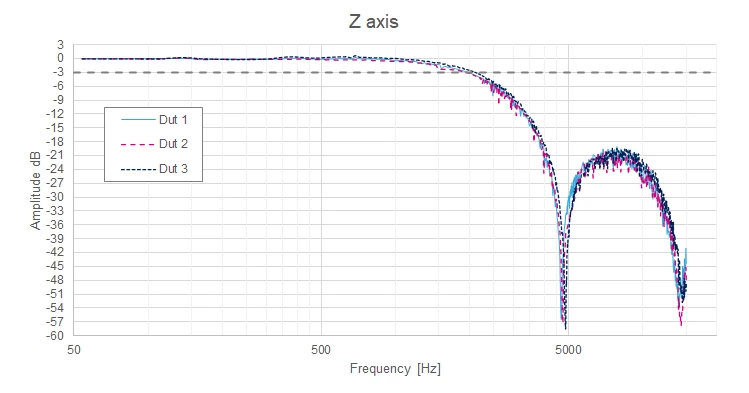

AFAIK the IIS2DH has no anlog anti aliasing filter. So will aliasing occure if I use low ODR settings and the input signal is frequency is higher than ODR/2? Because in our test we are getting quiten often spikes in the signal output signal.
And if this is the case we could only crank up the sampling rate?

Hi @THart.14​ ,
A little aliasing effect will probably occur, but the folded signal should be very attenuated.
This is for example the frequency response of the Z axis, that shows that the signal is very attenuated above 2kHz (which is half of the maximum ODR setting, Low-power mode (5.376 kHz)).

But at lower ODR settings the chip will use lower ADC sampling rates eg at ODR=200Hz or 400Hz, thus this will lead to aliasing effects?

Please could you clarify that in the case not properly low pass filtered input acceleration data the only way to avoid aliasing is to set ODR to 5376Hz?

Hi @THart.14​ ,
for lower than maximum ODR there is a low risk of aliasing folding, but the signal will be very attenuated.
