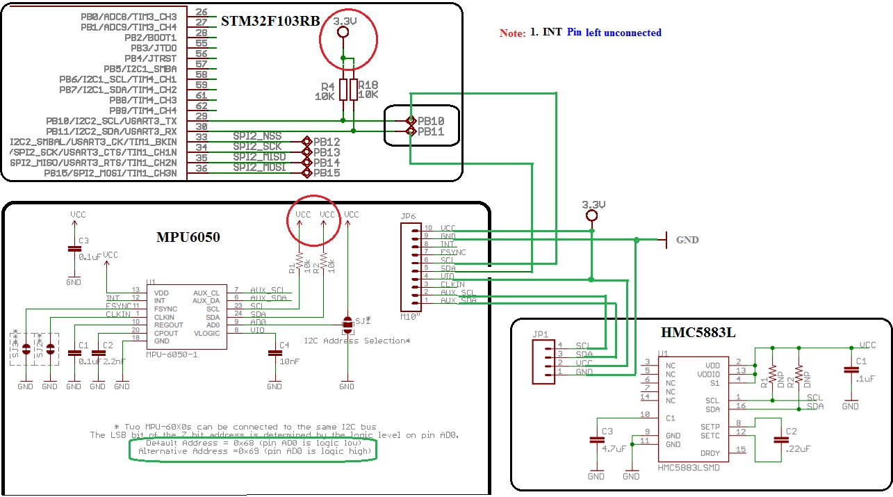

I have STM32-P103 board which uses STM32F103RB micro. I connected I2C sensors to I2C2 pins as shown below :
0690X000006050uQAA.png I use only 4 pins of the sensor, SCL, SDA, Vcc, GND.I have the following Initialization code & reading code:

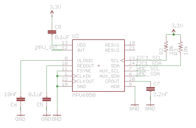

On your schematic the VLOGIC input pin on the MPU6050 doesn't seem to be connected to the I2C supply voltage.  This might explain why the MPU6050 isn't responding to I2C commands.

Hi Jack and others,
Jack & fm was right, It was my mistake that i did not connect VLOGIC pin to Supply.
http://www.sparkfun.com/
 breakout board schematic was the reason to commit to this mistake as it doesn't show connection of VLOGIC to supply(3.3V).
Once again thank you Jack & fm.

I hade a look at the MPU60x0 datasheet yesterday, and I agree with Jack.
The VLOGIC pin is listed as power supply for the logic block of the MPU6050, but for the MPU6050 only. According to the datasheet, this pin is not connected at the MPU6000 derivate.
