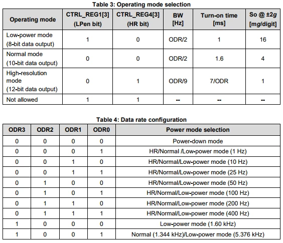

I want SPI communication code or application note for motion sensor LIS2DH12 with stm32f0 microcontroller. Thanks in advance.

I am not understanding the concept of normal, low and high mode for the motion sensor IC LIS2DH12.
Can anyone please give me some idea about this concept.
