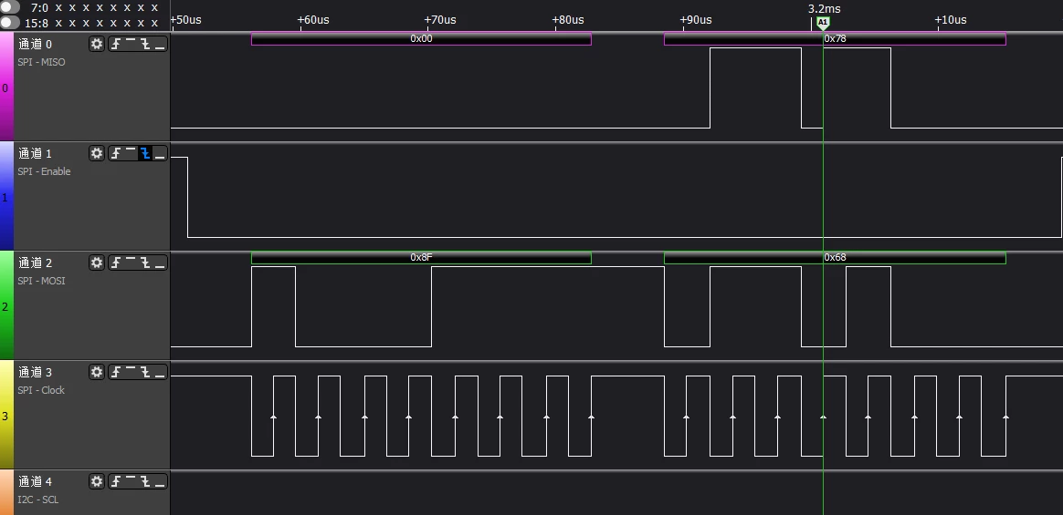

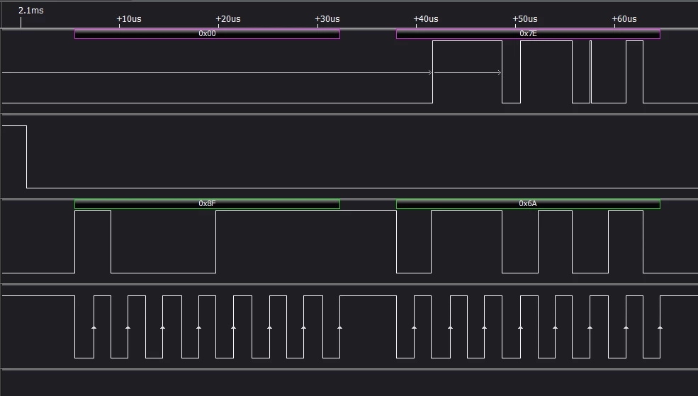

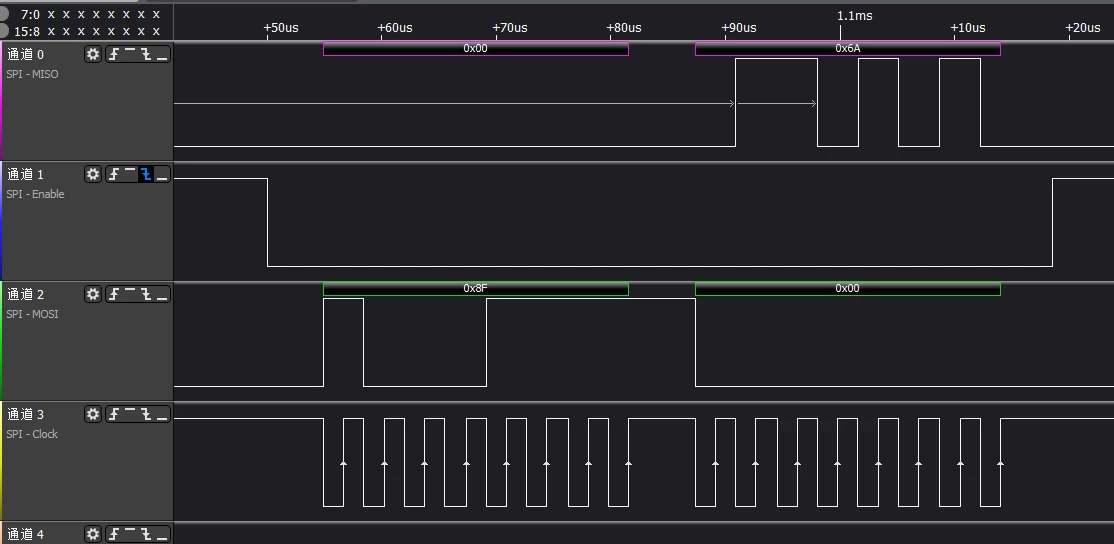

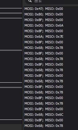

I use STM32F108C8T6’s SPI to communicate with LSM6DSM. First, I read the id 10 times, only the second time it returns correct, the rest is wrong, why?

Please note that the SPI read command is performed with 16 clock pulses, so if you place in a loop the SPI single register reading command, you have to send the command for that register and wait the second 8-bit slot for the register value reading, maybe not sending bits during the second 8-bit slots, as performed in the second and third lines of your first picture, and as described in the datasheet, p. 46.
loop (
MOSI 86h MISO 00h
MOSI 00h MISO 6Ah
You can also use multiple byte read command by adding blocks of 8 clock pulses to the previous one, but you will read consecutive registers and not only the WHO_AM_I in this way.
