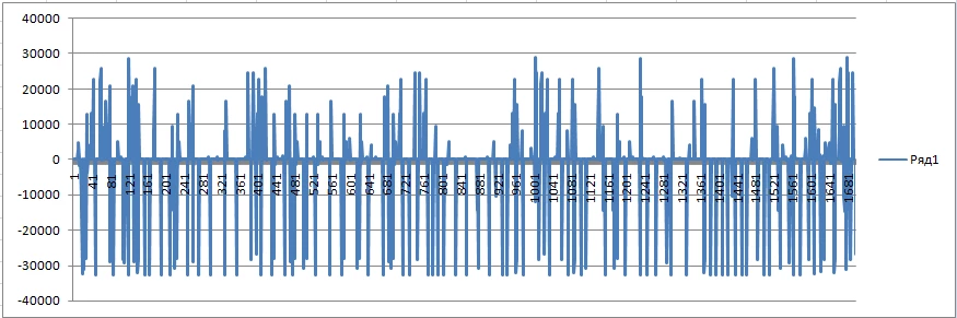

I use LSM9DS1 with STM32L433 and get strange data.

what is strange about the data ?
Vladimir Lobanov
August 2, 2018
On all channels, data jumps from 0 to ~ 60000, although the accelerometer is at rest.

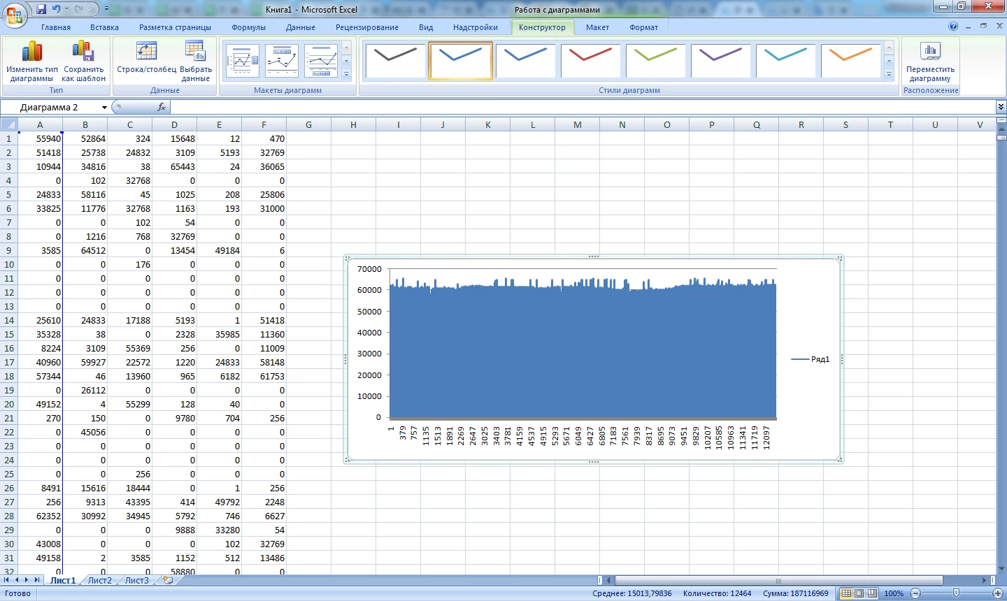

For example, X axys of gyro:0690X0000060QcxQAE.png

ooo,
you have negative numbers
+ and - 0
like this:
5,4,3,2,1,0,0xffff,0xfffe these are negative numbers just next to zero

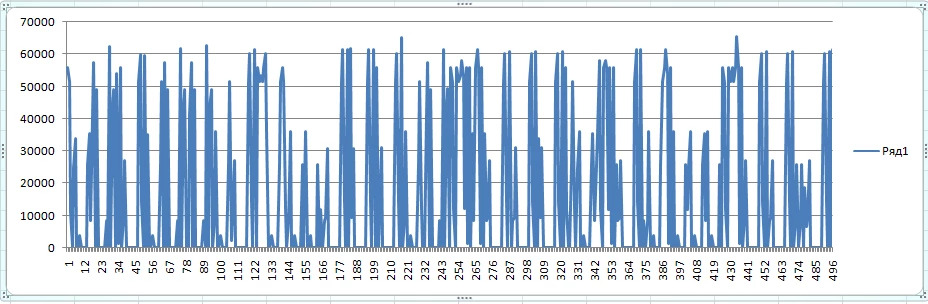

Well, if we take into account the negative values, then the amplitudes are still large (although the accelerometer is stationary)0690X0000060RHNQA2.png

do you have the bytes swapped ?

I read Lo and Hi bytes and convert it to int16:
HAL_SPI_Receive(&hspi1, &data_temp[0], sizeof(data_temp[0]), 0x1000);
HAL_SPI_Receive(&hspi1, &data_temp[1], sizeof(data_temp[1]), 0x1000);
gyro_temp[0] = (int16_t) (((int16_t)data_temp[1] << 8) | data_temp[0]);

I cant see the values, so how can I help...
are you sure the value are not reversed ?
or
gyro_temp[0] = (int16_t) (((int16_t)data_temp[0] << 8) | data_temp[1]);
