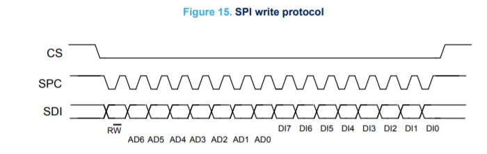

I use LIS2DW12 MEMS, via SPI. I can correctly read reg. 0x0F, I obtain 0x44. I can also write to regs CTRL2-CTRL6; the written vals can be read back afterwards. But I fail to write CTRL0/1, which always read back as default: 0x00/0x04. How write CTRL

Please accept my apologies, I checked the datasheet, but wrongly indexed CTRL-register names only in my post, not in my code, so correcting the post:
I use LIS2DW12 MEMS, via SPI. I can correctly read reg. 0x0F, I obtain 0x44. I can also write to regs CTRL3-CTRL7; the written vals can be read back afterwards. But I fail to write CTRL1/2, which always read back as default: 0x00/0x04. How to write CTRL1/2?

Hi Richiard @RHold.2​ ,
There should be no reason you cannot write (but you can read) these specific two registers.
Did you configured correctly the SPI communication in writing mode (datasheet p.31)?
0693W00000JNjdoQAD.pngTo investigate if the issue is related to the code, did you comment the line of the codes of CTRL1/2 registers, are you face issues with CTRL 3/4?
