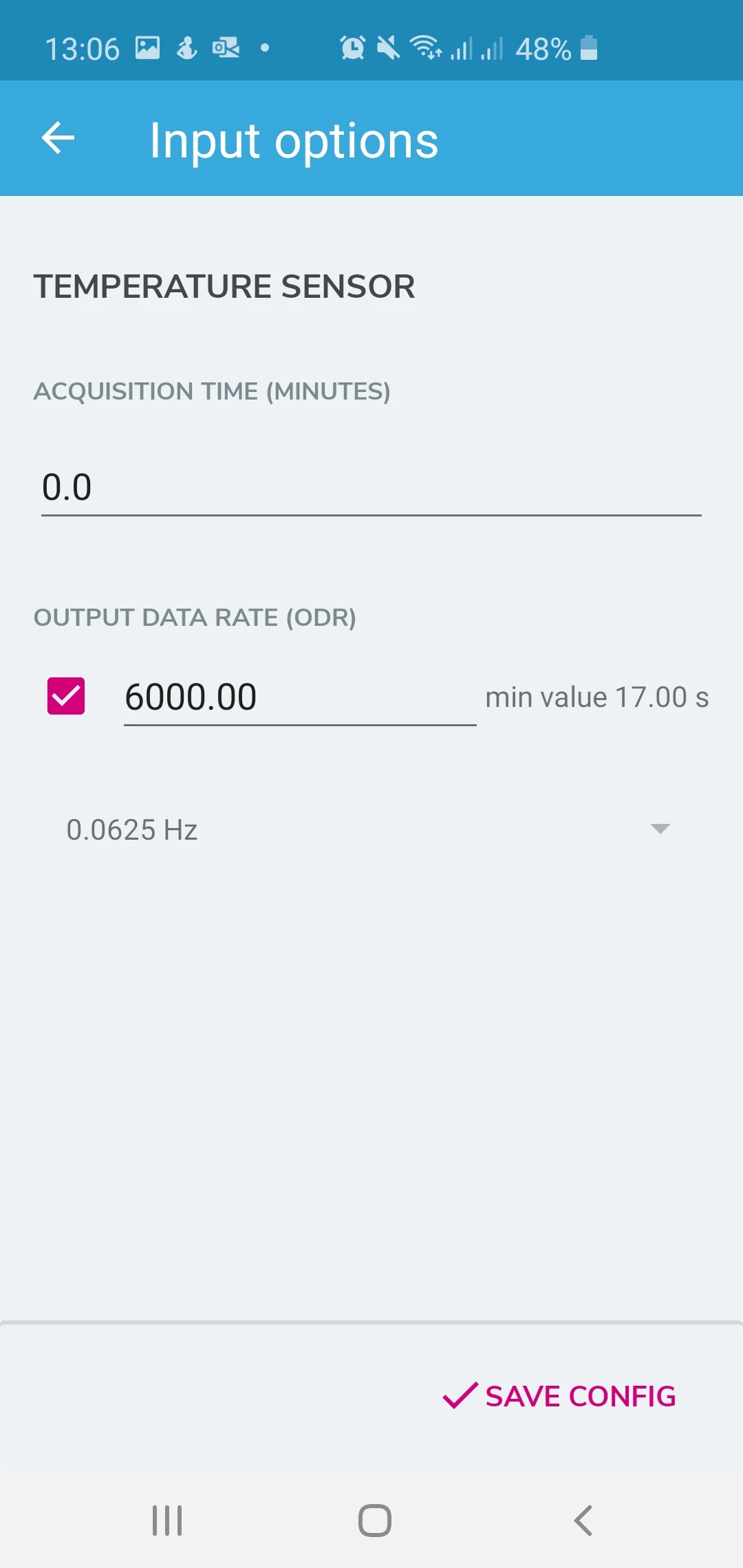

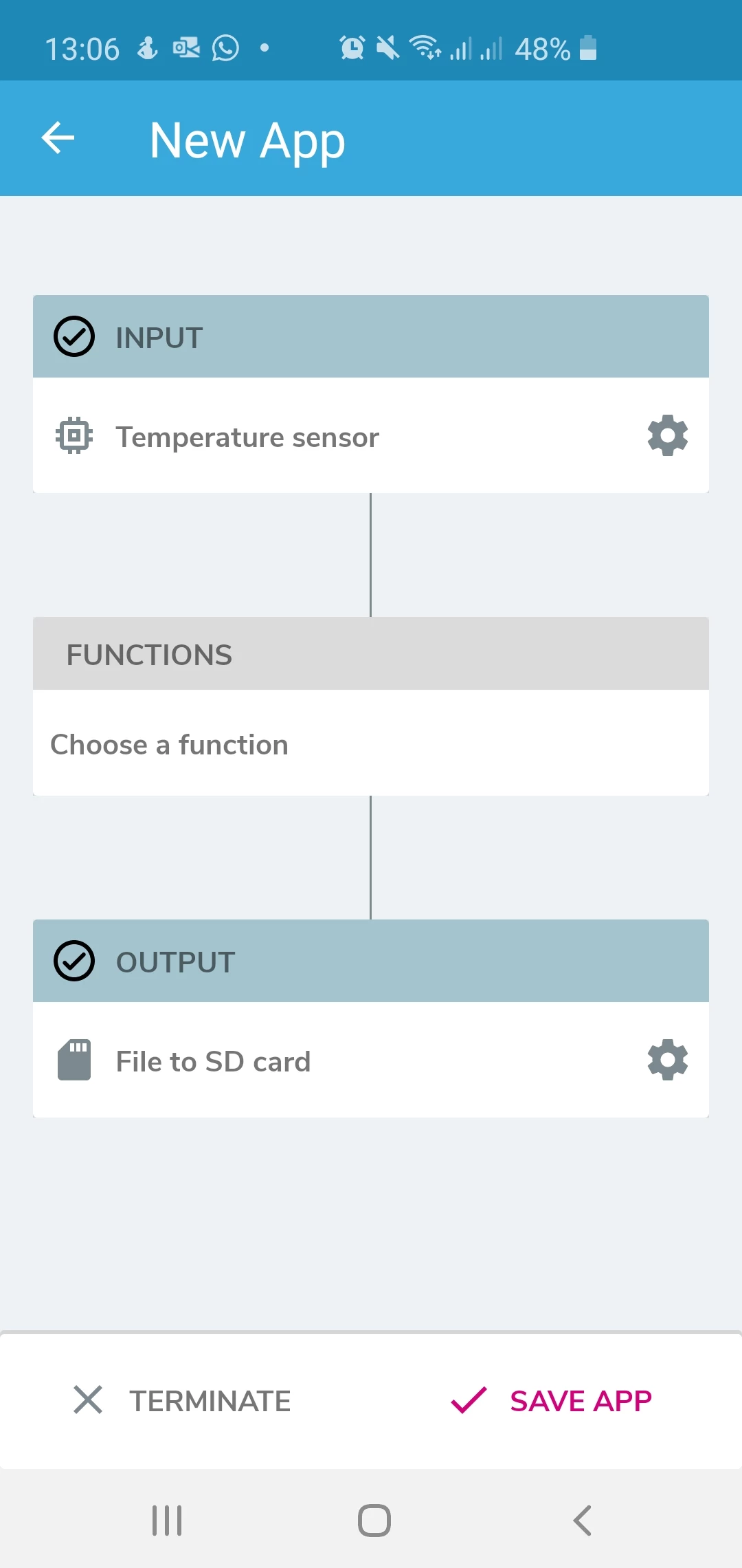

    Hi @Nicolás Martinez​ , the firmware package for the STEVAL-MKSBOX1V1 is available at this link (FP-SNS-STBOX1), you can start from the available examples.
    Btw, for your purposes you can use Mode 2 programming (Expert view) the temperature acquisition with the lowest ODR, saving data on the SD card. For a fully-charged battery, the optimized app (lowest temperature sensor ODR, SD card written once every long time intervals) will last up to 2 weeks.

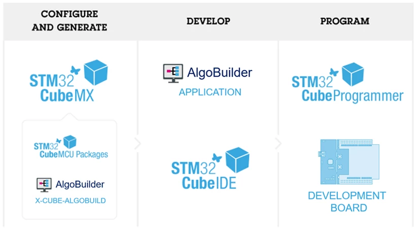

    First of all thanks for answering. I need to send data via BLE each time I read a temperature. I found a tool calle AlgoBuilder. With this tool I am going to be able to develoop my firmware?

    Hi @Nicolás Martinez​ , yes Algobuilder is an ST tool that support SensorTile.box template and from the last release (2.5.0) a firmware template for SensorTile.box with BLE communication has been added, together with support for firmware template created using STM32CubeMX and X-CUBE-ALGOBUIDL package. The logical flow is the one below:
