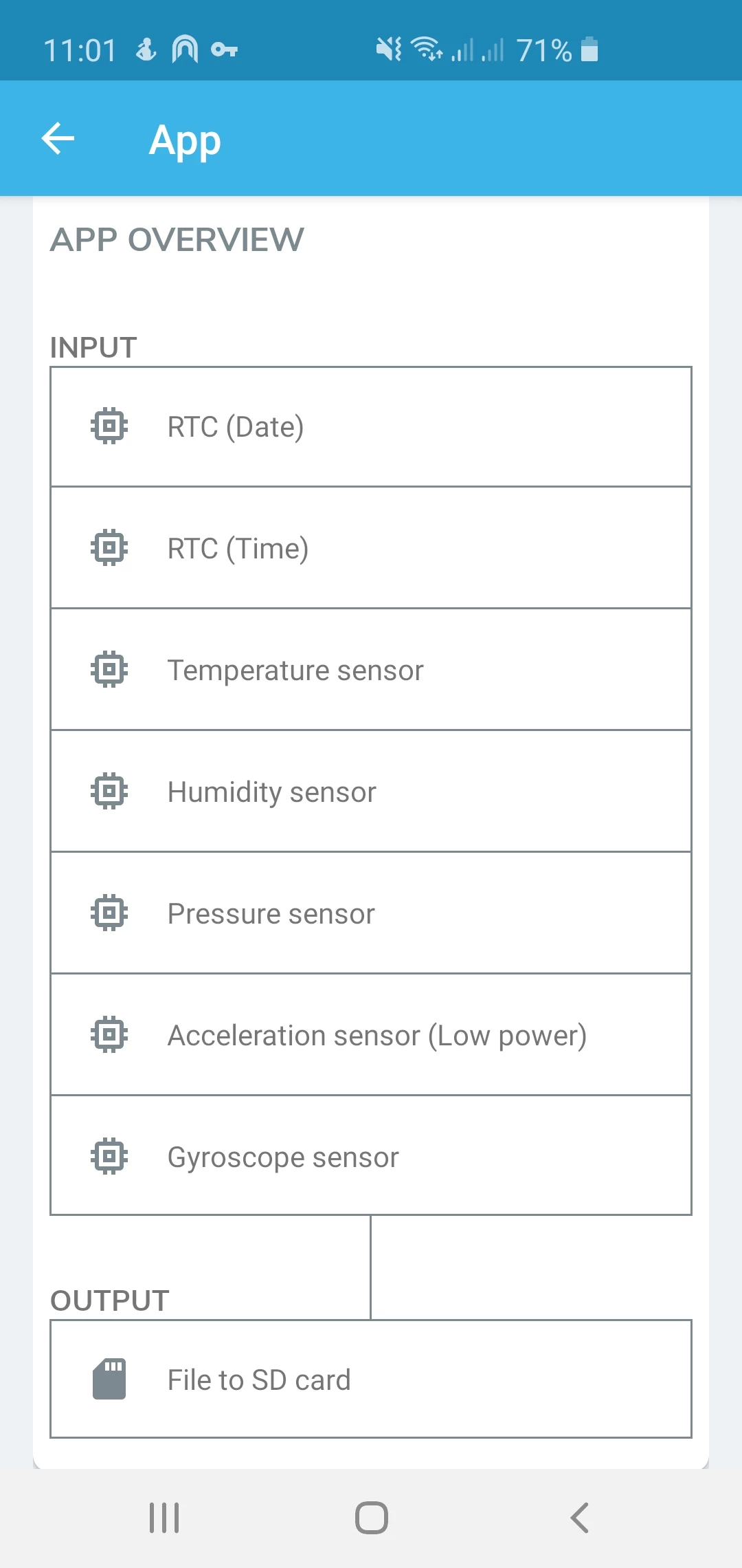

    Hi @MMarq.1​ , which kind of datalog structure would you like to save? Please note that you can create your own app in "Expert" mode, selecting the sensors in the order you want and save it on the SD card (except from the microphone which will be saved in .wav extension, 16bit 16kHz pcm). Here below the Expert mode configuration:

    Hi @Eleon BORLINI​, thanks for answering.
    I'm already successfully using the Expert Mode as you showed. I was able to save the output data with 'File to SD Card' and save DataLog while on "Stream to Bluetooth':
    The latter data format is quite what I want, but I need to save raw-data from multiple sensors simultaneously. Also, the app limits the ODR when streaming to Bluetooth and I need higher values.

    Hi @MMarq.1​ , about your statements:
    please consider however that the different sensors have different ODR and in general they are not related to reciprocal multiple values. So the datalog is synchronized on the greater ODR (e.g. 52Hz or higher for the gyro), and if for example the temperature ODR=1Hz, you will see 52 times the same value.
    >> I wonder if I need to get more hardware to make it work, (Link V3 to the board JTAG20) or it's just the USB cable connected to the computer.
    It is not mandatory to use the STLINK for downloading a new firmware on ST.box MCU. You can use the STM32Programmer setting the board in DFU mode and downloading the .bin file of the application, as described at this LINK.
