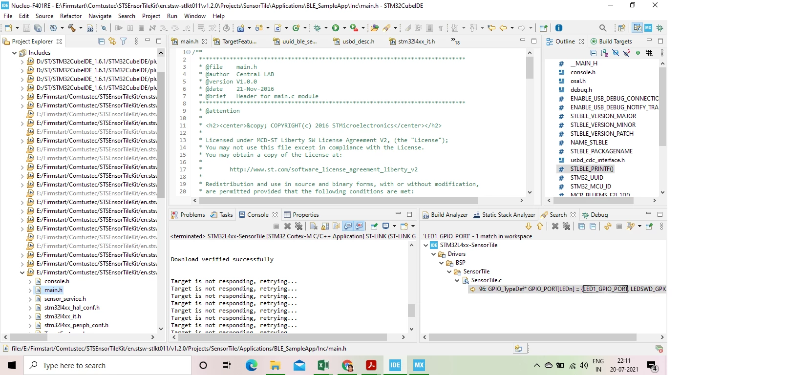

I have Sensortile.box (STEVAL - MKSBOX1V1) and Sensortile Kit (STELVAL -STLKT01V1). I need to check onboard LED port, UART port, BLE baord and sensor port where shall I find the details.
1) Port Details of this BSP - LED, BT, Sensors GPIO configuration details. In the source how shall I find it. Example if I download en.stsw-stlkt01, where shall I find the pin configuration details
2) Similar to UART and Sensors and BT Step by step guide , Starting from a new project to adding the details.
3) In sample code for BT where shall I find the device name, class name and advertisement request etc.,

    Hi @Snara.2​ ,
    you can find the details of all the connections on the schematics of the two boards:
    You can combine this information with the firmware code and check the of your interest.
    Moreover, for the Sensortile.box, it is also possible to start a code from scratch using the STM32CubeMX.
    For the Sensortile, instead, if you want to implement AI applications, I suggest you to start from the function pack FP-AI-SENSING1 (here for a presentation), adding your custom libraries in this code.
