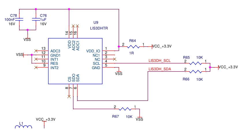

I have a current consumption of 1.2 mA after reboot with my LIS3DHTR.
Hi everyone,
I'm using a LIS3D in my schematic. Everything works fine. I can read the register "WHO_I_AM" without any problem.
BUT : I have a current consumption of 1.2 mA. Can you help me ? I don't understand how is it possible.
Here is my schematic :
I'm working with an I2C interface.
Thanks for your help.
Best regards
    Miroslav BATEKBest answer
    Dec 18, 2018 2:04 PM UTC
    CS pin cannot be floating, if you use I2C connect the CS pin to VCC.
    R67 on SDO pin creates voltage divider with internal pull-up and the level won't be well defined.
