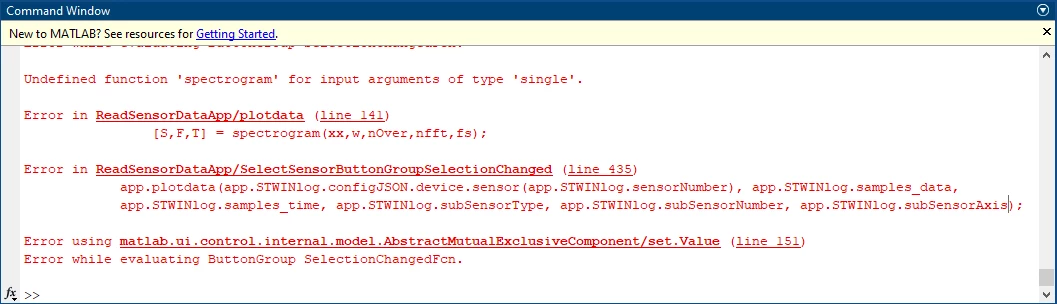

I get an error by using the spectrogram of the mlapp function
Hi, I am using a Stwinkt1a and the datalog 1.2.0. In this funtionpack i am using the ReadSensorDataApp.mlapp for visualization. The Time diagram is not the problem but with the spectrogram an error occured, that i quite don't understand.
Thanks in advance

    Hi Philipp,
    the spectrogram function is in the Signal Processing Toolbox. Do you have the license for this?
    -Eleon

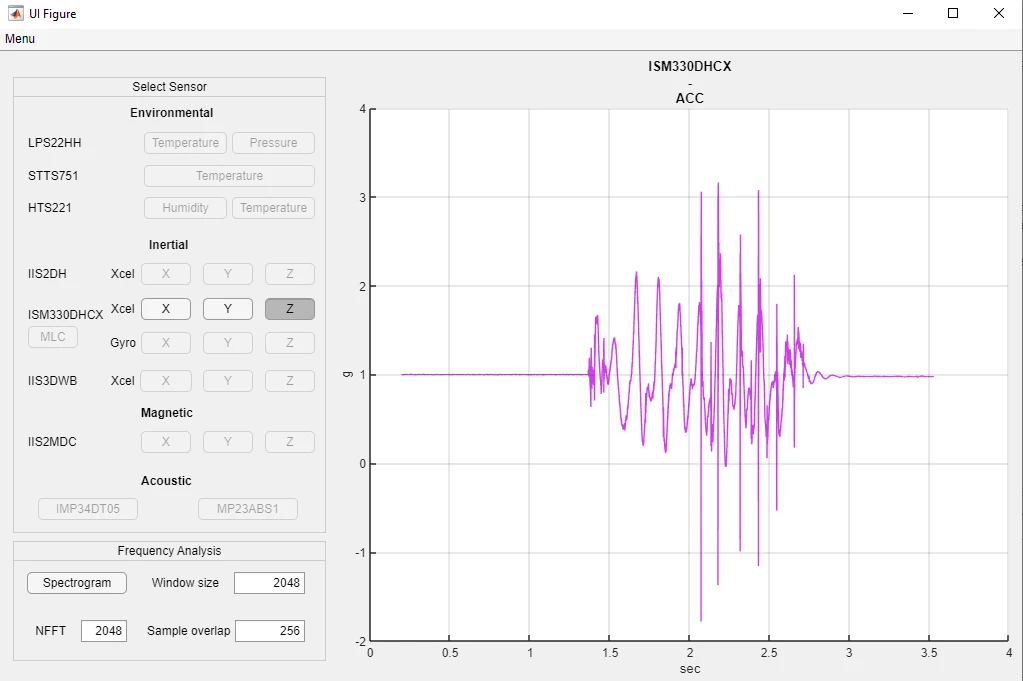

    PReit.1
    PReit.1Author
    Jul 23, 2021 8:26 AM UTC
    Hi @Eleon BORLINI​ ,
    i am currently using the HSDatalog.bin from the 1.2.0 function pack. I made a log via BLE Sensors App and then i let the mlapp show the data.
    I did this according to the UserManual 2688 and, as seen in the right picture, there is no problem with the time signal. The error occured after pressing the Spectrogram in the bottom left corner.
    Philipp

    PReit.1
    PReit.1Author
    Jul 23, 2021 9:54 AM UTC
    Hi Eleon,
    i hope this seems to fix the problem. Honestly it should have been obvious, I only used the toolbox via matlab web application so i need to extend my license on the pc.
    Hope this will do it. Thanks for your help.
