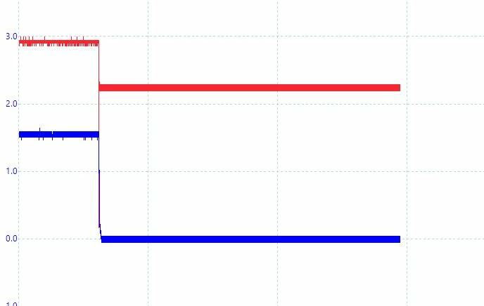

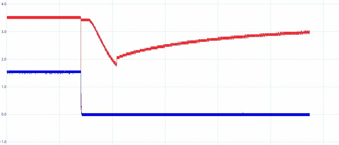

    Hi @Eleon BORLINI​ ,
    for better understanding I can share two pictures from Scope. If the Motion sensor power supply is 1.8 V there is no ramp and INT1 works clean. If i set power supply to 3.0 V then i see the ramp. Here is also my configuration for Activity in motion sensor same as ST application notes. If i just have a correct definition for this differences and reason of it, could be helpful to me. The red line is INT1 and blue one is Power supply. With regards

    Hi @Yeko.ER​ , please help me to understand... in the picture here above, the Blue line is 1.8V (are they Volts on Y axis and maybe milliseconds on X axis? Why the Red line is going down and then up when the blue line remains down? Regards

    Thanks for your comment. Yes , you have got it correct. X axis is Voltage and Y is millisecond. Red line is INT1 and Blue Line is Voltage for Hardware which i have connected to AIS2DW12 . My expectation and aim was after wake-up duration INT1 deactivate my Hardware and it is correct. " Why the Red line is going down and then up when the blue line remains down?" This is exactly my Problem and reason i have asked here. Asyou can see in the last picture it is correct but there the Hardware voltage has already set to 1.8 and here with this funny curve hardware Voltage is 3.6.
    Well simply we can say it is like this. Set AIS2DW12 Supply Voltage on 1.8. But i should know the reason why i have this Curve when i set supply Voltage to 3.6. In datasheet there is nothing about Typ or Max voltage.

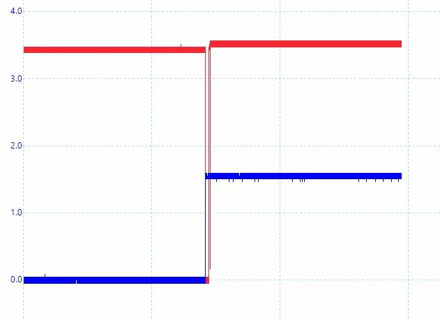

    Here is the Picture with 1.8 V in power Supply
