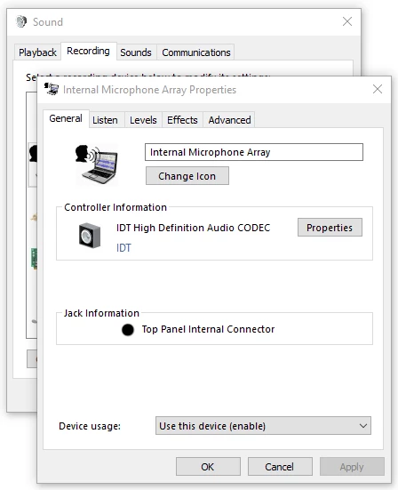

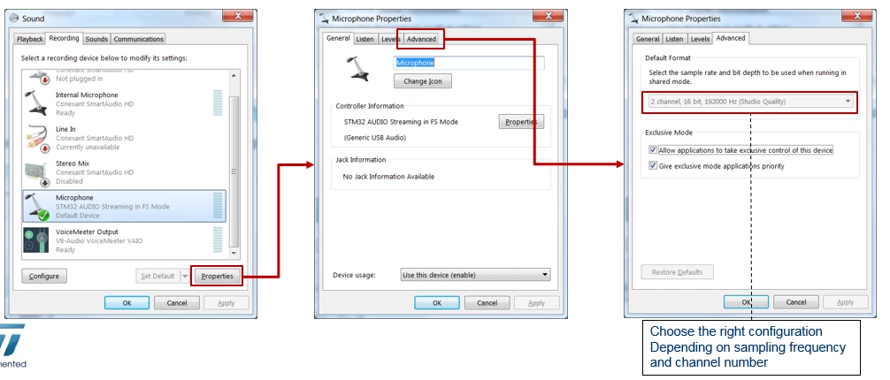

    Hi, if you are using win7, the device is recognized as a standard, xx channels microphone. If you did't already do it, you should check the mic configuration, right clicking on the loudspeaker icon on the bottom right of the windows screen and choose “Recording devices�? in the following way. Regards

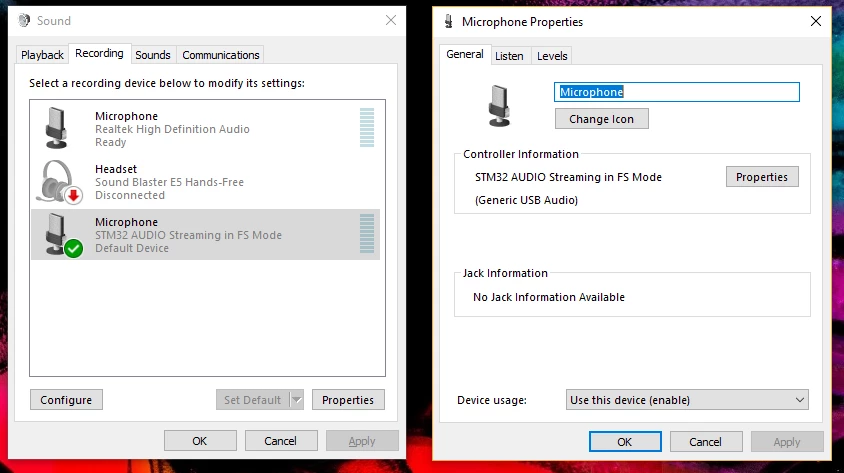

    I am using Win 10,
    that is what I see when the configuration is 2 channels, 48000 sample rate.
    the Advanced Tab not exist.

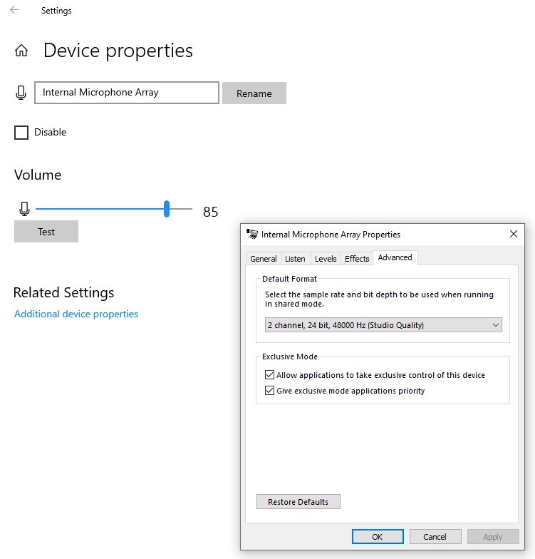

    You may try this other way. Go to Sound settings --> Input --> chose the correct input microphone --> Device properties --> Additional device properties --> Advanced
    -Eleon
    JHuang
    Visitor II
    Sep 17, 2020 7:32 AM UTC
    That is exactly what we do. The problem is: the Advanced tab is not there, if we set other sampling rates (except 192KHz in my situation) in the project and build and run.
