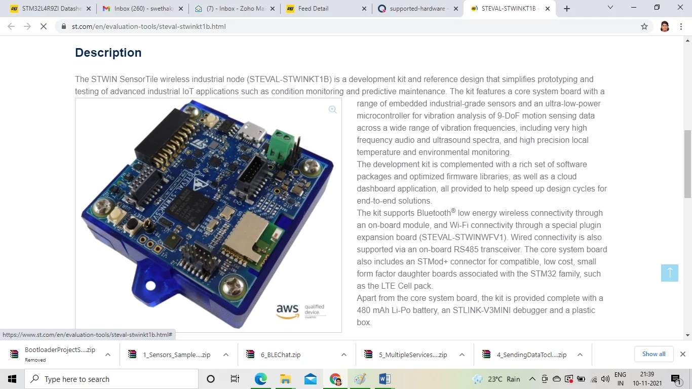

    Hi @Eleon BORLINI​  Whether STEVAL-STWINKT1 supports BlueVoice, Is there is any comaprision between STEVAL - MKSBOX1V1 Vs STEVAL-STWINKT10693W00000GX97aQAD.png
    Eleon BORLINI
    Eleon BORLINIBest answer
    November 12, 2021
    Hi @Snara.2​ ,
    I'm afraid that the BlueVoice library is not (officially) supported by the STEVAL-STWINKT1B.
    Especially if the business behind is not negligible, you might try opening a ticket in the OLS page, asking for a custom firmware package.
    -Eleon
