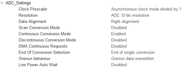

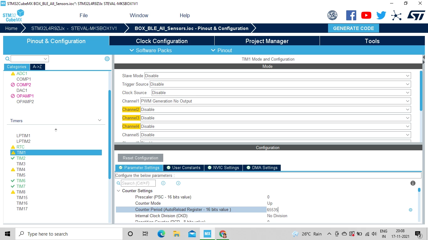

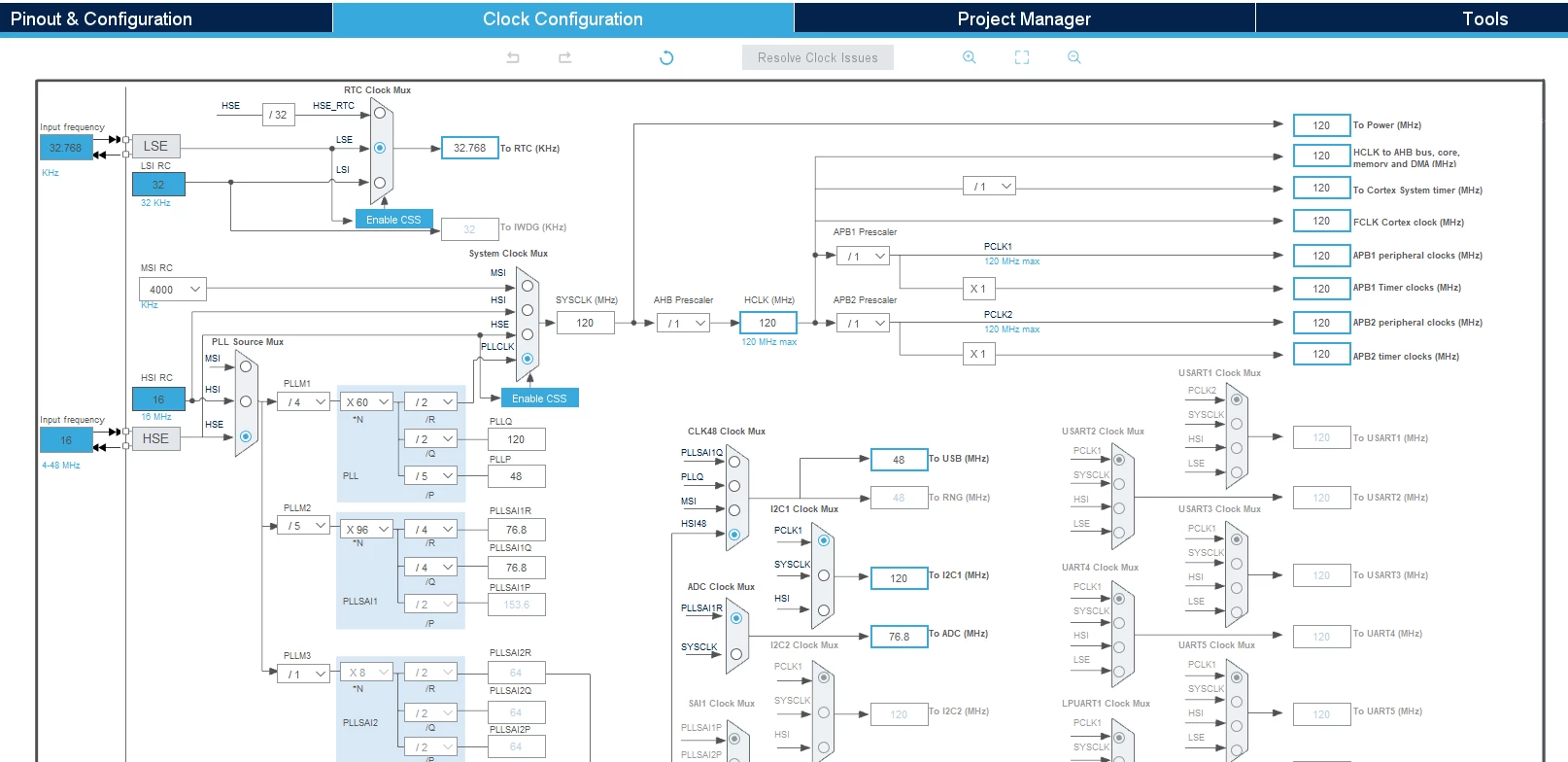

    hi @Eleon BORLINI​  I have tried that please let m eknow how shall I configure cube MX
    1. How to configure ADC in STEVAL - MKSBOX1v1 (With DMA or W/o DMA)
    2. How are the setting to be used for this board. (Clock dividing by ?) - For Audio it will be single channel continuous scan
    3. There are two pins in STEVAL - MKSBOX1V1 MREF and M1P what should I do that in MX and in the firmware function
    4. Whether any firmware logic is there for ADC Microphone if so please share the reference. If I create the [roject it has to work with the code I create, so please share the [rogramming manual for Analog Microphone

    Hi @Snara.2​ ,
    I believe you should start with the predefined peripherals configuration in CubeMX for the SensorTile.box. In particular:
    • How to configure ADC in STEVAL - MKSBOX1v1 (With DMA or W/o DMA)
    The default configuration of ADC1 is without DMA. This ADC is dedicated to the analog microphone acquisition.
    • How are the setting to be used for this board. (Clock dividing by ?) - For Audio it will be single channel continuous scan
    You can find the default clock tree configuration in the proper tab. The master clock is 120MHz. I would use this configuration.
