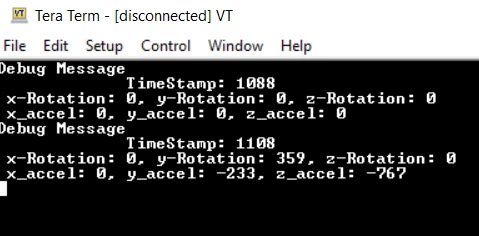

I am using MotionDI library with sensortile (STEVAL-STLKT01V1).I modified the existing 'DataLog' application to include MotionDI_update function. But the MotionDI_update function halts after giving the rotation and acceleration once. How to resolve t

    I want continuous output that indicates the tilt orientation and linear acceleration of the device. Any help or guidance regarding the query will be appreciated.

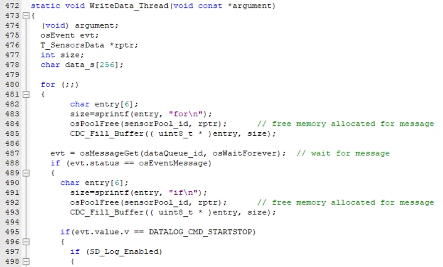

    Meanwhile, I want to tell you that my initial debugging suggests that the issue is in line # 487 of the code image attached to this message. The message does not seem to arrive within the timeout limit. What is going wrong?

    I tried increasing the stack size but the problem remains same. Please let me know what else I can do to get my code working? I am attaching the relevant sections of my code.
