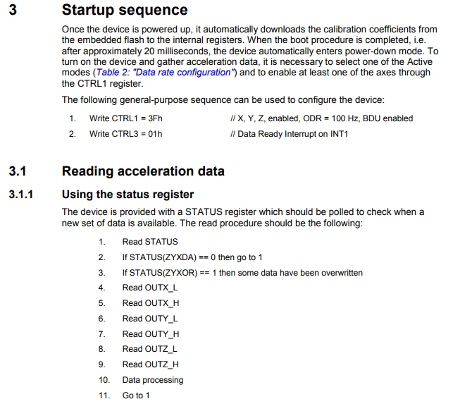

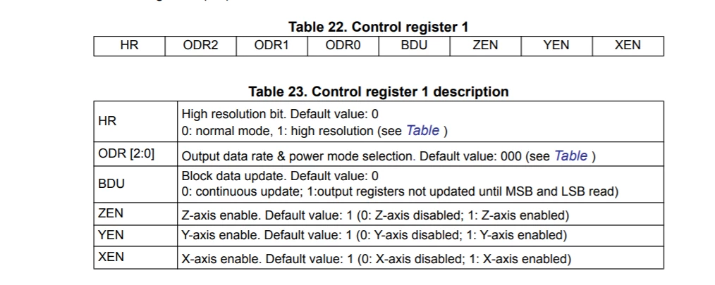

in the following image the registers for x, y, z are enabled already0690X000009jxW2QAI.pngI
Ozone
Principal
October 3, 2019
Enable means, the sensor generates sensible measurements that end up in this registers.
Reading them is a different matter, and not related to the control register.
Section 6.2 of the datasheet should tell you how it's done.
Access wide is 16 bits, and you have to give the R/W bit and the register address first, followed by data - or dummy data for a read.
Section 7 list the register addresses (offsets).

Hi @RNata.15​ , in addition to @Ozone​ suggestions, please follow the indication regarding device power up configuration and axl data reading at p.13 of AN4662. Regards

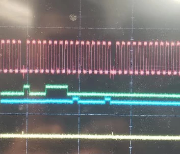

Thank you for your patience and trying to help me out. The below image is of when I try to read from "who am i register" and I am getting the readings.
I did follow the steps as you said by writing the value to ctrl1 register and ctrl3.
but I am not able to get any values.
I am following the read and write bit as you told me.
Kindly help me out here please.
I have attached the code for reference

I think you are aware of the synchronous nature of SPI. Meaning, the first byte the slave sends while you transmit is meaningless and has to be discarded.
> while(!(USART1->STATUS & USART_STATUS_TXBL)); //while this is not true, transmit buffer not empty
I don't know your MCU (EFR32), but assuming ST-like semantics, "transmit buffer empty" means the value to send had been moved to the output register, but not that the SPI transaction is finished. You would need to check with the serial/SPI section of the EFR32 manual.
With STM32 parts, the Tx register is an interface for the core. A Tx register value is transferred to the actual transmission hardware when no other transaction is ongoing. Transmission then takes the time required according to the interface's configuration. A completed transmission finally sets a flag in the status register.

The byte you receive while clocking out the address value (register offset) is meaningless.
This is the nature of SPI. To returning some meaningful answer, the slave has to receive the "command" first - i.e. the R/W bit and the address. Synchronous SPI clocks out whatever happens to be in the slave's TX register at that time. With the second byte, the slave is able to fetch the requested register and copy it to the SPI TX register.
That's what the datasheet implicitly says with the SPI diagrams.
